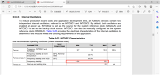

    Is there a relationship of F28004X's internal osicllator 's tolerance with temperature can be  provided?
    As the picture shows, the tolerance can be -3%~3%。I want to fix this problem with slightly changing the CAN baud rate with the temperature to meet at least 1%  tolerance.

  • I believe this is being handled off forum directly with the end customer.  Please let me know if you need me to re-open this thread.  There is no new update on the above information from my side, there is not additional data we can give wrt the exact variation at specific temperatures for the internal oscillator.
