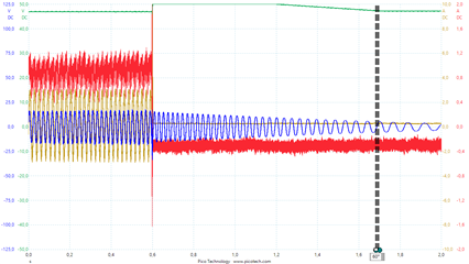

    We adjusted the motor parameters much more and we further tuned the SMO, with the system not responding as well as well as we hoped. We then added an encoder onto the system and set the feedback of the encoder to the Speed PID loop. This also did not seem to help. I have attached a few images to show the waveforms of the current and voltage:
    The Blue waveform is the phase voltage of the motor (Phase A), the red is the DC current into the control board and the green waveform is the DC voltage into the control board. This is occurring at steady state at 750RPM. It is observed that the current being drawn is around 800mA.
    However when the the controller is asked to increase the speed to 825 RPM, the current starts to oscillate and waver. Attached is where a major error occurs
    It can be seen that the DC current in oscillates majorly, and actually becomes negative when the motor speed is increased for a short time. This causes the phase voltage to have oscillations at the peaks as seen below
    Another instance of operation is where we are measuring the phase current and the short circuit appears.
    We think the issue may be on the DRV chip that the VGS is to low or climbs to slowly and may cause the VDS to shoot up and cause the latch down of the MOSFET by the DRV chip. Would this be a cause?
