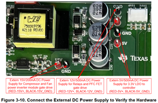

    provide some pictures for the connection :see attached image of fan connection
    Please suggest.

  • You may try to run a generic motor without load first, and use the example lab to identify the motor parameters directly.  And then run the motor with load to see what happens.
    50~400W motor on Fan side.
    100~1500W motor on Compressor side.
    What input power supply is used to board? DC or AC? What voltage?
    Is the PFC enabled?
    Any bits are set in motorVars[0].faultMtrUse.all or motorVars[1].faultMtrUse.all?
    Running the motor on Fan or Compressor separately to check if there is still a fault?
    Don't connect anything to the J17 and J18.

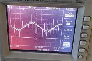

    Can you provide any current waveform captured by the oscilloscope with a current probe?
  • Hi Yanmng,
    What motor is running on the compressor side (motorVars[0])? : BLDC motor 200-240VAC,50Hz,4035W,2.99A
    Any load is adding on the motor?:No Load
    / false->enable motor identification, true->disable motor identification
    userParams[MTR_1].flag_bypassMotorId = true;
    userParams[MTR_2].flag_bypassMotorId = true; : these flag already set.
    Below are the observation
    1.Fan motor initially not commuted smootly for 2-3 seconds and after 2-3 min its stops.
    2.compressor motor runs only for 5 seconds & then stops
    Note:1 we have connected fan blade to fan motor as a load
             2.compressor motor only condesor coil is connected.
    Please suggest.
    Any information about this?

  • Dear Yanming,
    Any current waveforms captured to show this? :refer attached picture.
    You can try to tune the startup current as blow that could be a low value for your motor,
    #define USER_MOTOR2_ALIGN_CURRENT_A (1.0f) //
    #define USER_MOTOR2_STARTUP_CURRENT_A (1.0f) // This both parameter set(0.5f) low value but still motor not run smootly at initially.
     One more question is How to decrease Fan motor RPM in code please explain.
  • Any current waveforms captured to show this? :refer attached picture.
    What's the amplitude and frequency of the motor phase current? What's the target frequency and feedback frequency of the motor you monitored in the CCS debug window?
    Did you identify the motor parameters successfully on this board? Try to tune the identification variables below according to the motor....

  • Comparison 17W & 45W Motor.xlsxDear Yanming,
    with 17W motor Set speed & feedback speed we are getting ok with RPM changed accourdingly But with 45W Motor feedback speed not same & RPM not vary accourdingly,attached comparison of setting of measurement of with 17W & 45W motor with same set parameter.
  • For all information:Motor 2 i.e Fan motor
    What's the amplitude and frequency of the motor phase current? :Pk-Pk Current :8.0A & frequency=18KHz ,also refer attachement
    What's the target frequency and feedback frequency of the motor you monitored in the CCS debug window?:Set freq=30Hz & Feedback freq=64Hz ,Also refer attachment.
    Did you identify the motor parameters successfully on this board? :Not Understood
    What do you mean this? You can set the target speed by changing the value of the motorVars[0].speedRef_Hz or motorVars[1].speedRef_Hz as shown in the lab user's guide.:where trying to changed the freq but it is not getting changed,refer attachment.
    Note: fig.3 & fig.4 for information.Phase_Current_&_Freq_wf.xlsx
  • What's the target frequency and feedback frequency of the motor you monitored in the CCS debug window?:Set freq=30Hz & Feedback freq=64Hz ,Also refer attachment.
    Seems like the motor parameters are not correct for FAST estimator.

  • Dear Kevin,
    For TIDM BOARD, can I supply 5v to external power supply???
    Also can I connect TTL ground is connected to mcu ground??
  • Hi Babaji,
    Yes, you can supply power to the different low voltage rails externally / separately. See below from the User's Guide.
    Yes you can. How and where are you connecting the RX and TX signals on the board? On the R11 & R8 resistor pads or somewhere else?
    Kevin
