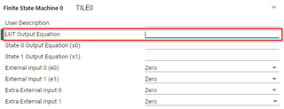

  • Hello Colin,
    We do not have any examples of using the FSM as a LUT I believe, is there a reason you need to do this? Based on the design you have in your initial post you need 3 2-input LUTs, which there are available for the F2837xD device. Are you needing an extra one? If so, it should be possible to create a 4-input LUT based on this detail in the technical reference manual:
    In SysConfig, the 16-bit output equation is the "LUT Output Equation":
    Omer Amir
