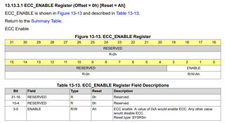

1. From the TRM, it shows that ECC is enable as default for the whole FLASH.
2. Does F28386D support to enable or disable the ECC for each sector seperately and set the threshold seperately  (the single bit error threshold)
