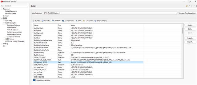

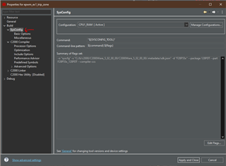

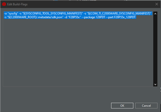

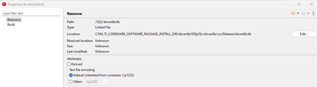

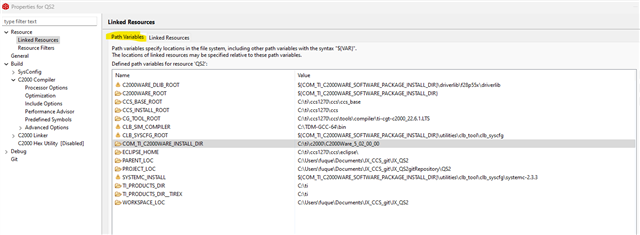

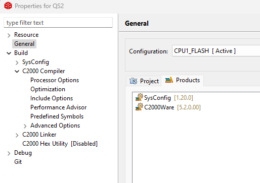

I used to use CCS12.5 + C2000Ware_5_02_00_00_EA1 on my  F28P55x project, after a bunch of manual ZIP file extraction, because  F28P55x was not officially supported yet.

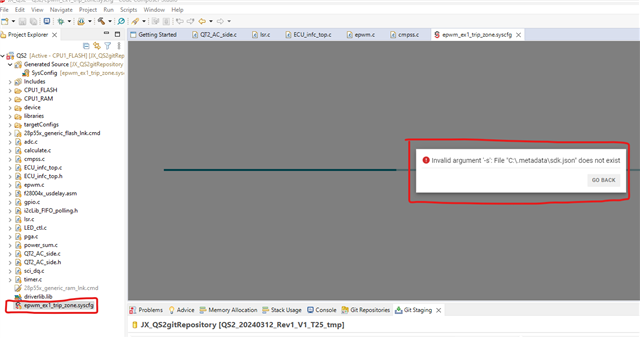

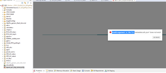

I now upgraded to CCS12.7 + C2000Ware_5_02_00_00 which have native support of  F28P55x without any manual ZIP file extraction like we had at FCS. When compiling the same project, it errored out like below:
Could you advise how to fix this issue?
