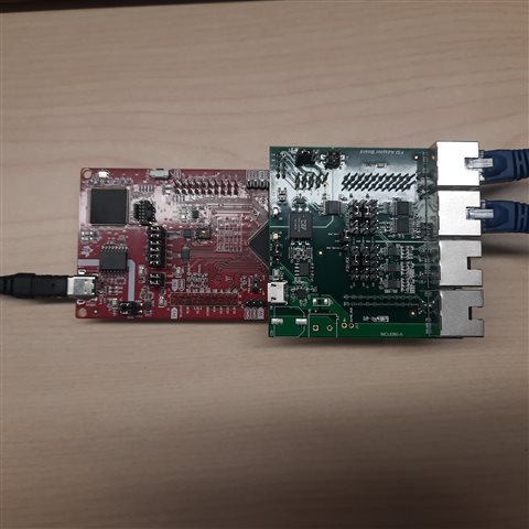

I am trying the example: fsi_ex1_loopback_cpucontrol in external loopback mode with the TMSF28P550SJ Launchpad board and the FSI adapter TMDSFSIADAPEVM on top of it.

I have checked the hardware connections, and it is correct as it works for other clock speeds. I have checked the GPIO mux configurations, and they are correct as well.
I debugged the issue with CCS Debug mode as follows:
When working with 75MHz, the ping from the FSI TX module does not seem to reach the FSI RX module, and the PING Watchdog times out even before starting the data transmission. This happens at the following line in the fsi_ex1_loopback_cpucontrol.c file:

After the FSI_enableTxPingTimer API call, the RX_EVT_STS register must have the value : 0x0240, i.e., PING_FRAME and FRAME_DONE must have the value 1. This means that the automatic ping transmission is setup and ping frames have reached the FSI RX block. However, at 75MHz, the register value remains at 0x0000, so when the next line in the above code runs and enable the FSI RX Ping Watchdog, it times out as no ping has been received and thereby the FSI INT2 interrupt stops the program.
Questions:
How to get around this issue?
Should I configure the skew compensation block in FSI RX module as there is a possibility that at such high speed (75MHz), even in external loopback mode with small channel-to-channel length using CAT5 cable, the FSI RX module is unable to properly latch the data with the received clock? If yes, please provide some high-level steps to do this, as FSI skew compensation examples are only available for TMS320F28004x boards.
Or is there something else that can be done?
I am also encountering the same issue with TMS320F280049C_MCU_025B Launchpad board at 50MHz FSI clock in external loopback with the FSI adapter board.
