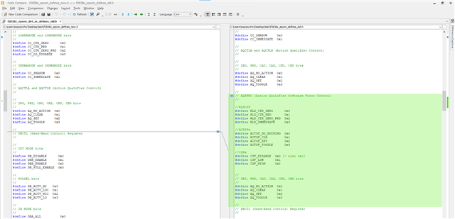

Dear experts,
I noticed some differences in f2838x_epwm_defines.h driver file during the porting of the project from SDK  c2000ware rev 3.4 to c2000ware rev 4.0.
  Here below the differences.
Specifically, I noticed that some defines have been removed in the new rev.
May you explain me the reason behind this choice?
These defines are necessary in my project because I configure the bitfields of the registers involved.
Waiting for a your feedback....
Benito

  • Hi Benito,
    I don't recall we had these Macros in the first place. I double checked by installing the 3.4 version of the C2000ware. Could you re-check if these are manually added Macros by the user themselves?

  • Dear Madhava,
    these Macros have not been manually added.
    They are original Macros of the TI library to configure the EPWM regs.
    They have been removed in the C2000ware rev 3.0 or latest.

  • Hi Benito,
    Could you please mention the C2000ware version that you were using where the macros are present ?
    thanks,
    Madhava
  • The MACROS are present in the C2000Ware v3.04.00.00
