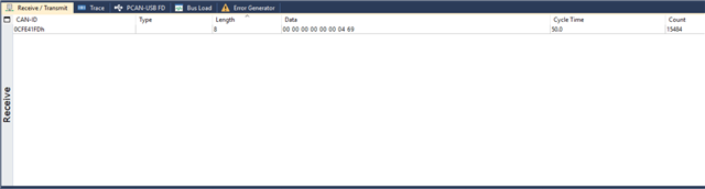

Hi TI Experts,
I have a project using MCAN for TX and RX communication. The CAN configuration uses the standard CAN protocol with an extended frame ID and a baud rate of 500K.
I would like to receive data using the RX buffer in interrupt mode. However, when I send a frame with the corresponding ID from PCAN-View to the F280039C, I do not receive any RX data. Additionally, I have set up a breakpoint in debug mode for the RX interrupt, but the interrupt is not being triggered.
Below is my code. Could you please help me check why the RX is not working?

  • Hi Allan,
    Just to confirm, MCAN in F280039 is configured to operate in classic mode, not in FD (flexible data rate), correct?  There is a classic CAN module as well in F280039 in case you only need the classic mode operation, which is more straightforward to implement.
    I see you started with example 7 classic transmit and modified the code from there for the extended ID.  What I do not see that is configured for classic CAN transmit operation is fdMode  being disabled.  One suggestion is ti use mcan_ex4_receive as it is and within function MCANConfig() function assign below values to 0:
        // Configure MCAN initialization parameters
        initParams.fdMode            = 0x0U; // FD operation disabled.
        initParams.brsEnable         = 0x0U; // Bit rate switching disabled
    In PCAN, send classic frames at 500kbps using either of the message IDs 0x123, 0x124, and 0x125.  Use standard IDs for now just to check that the MCAN is configured to receive classic frames.  This would confirm you have proper settings for classic frame reception.  If this works, you can proceed to convert the message ID to extended form and go from there.
    Joseph
  • Hi Joseph Casuga,
    I’m using Classic CAN, not FD mode. Initially, I only needed the TX function, so I modified Example 7 for my use. However, now I have a requirement to receive (RX) as well, so I added the necessary RX configurations based on Example 10.
    My hardware currently requires using MCAN T/RX on GPIO 50 and 51, but these GPIOs do not support the Classic CAN module. Could you please help check whether my original RAM configuration and interrupt usage are correct?
    Thank you!
    Allen
