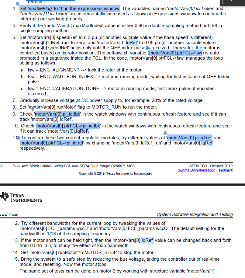

I'm using BoostXL3PhGaN with LAUNCHXL-F28P55X. The project is dual_axis_servo_drive.
I am following these steps:
1) Set 'motorVars[0].speedRef' to 0.3 pu (or another suitable value if the base speed is different) .. 'motorVars[0].speedRef' helps only until the QEP index pulse is received. Thereafter, the motor is controlled based on its rotor position.
Tell me if I have understood correctly: after the encoder calibration (so when lsw = ENC_CALIBRATION_DONE) motorVars[0].speedRef no longer has any effect, so I no longer need it. Right?
2) If I have understood point 1) correctly ... how do I adjust the speed? Can it be done in FCL_LEVEL3? Or does it remain fixed?
3) Gradually increase voltage at DC power supply to, for example, 20% of the rated voltage.
Is this step necessary? 20% is a value below the minimum threshold that triggers fault undervoltage ... why can't I debug and start directly with rated Vdc? I currently do this with Vdc=30V and have no problems.
4) Set 'motorVars[0].IdRef_run' to zero, and 'motorVars[0].IqRef' to 0.05 pu (or another suitable value) and all these things:

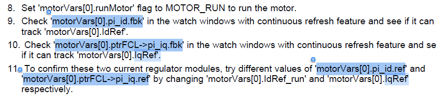

4b) Instead, by setting, "motorVars[0].IqRef":
- "motorVars[0].ptrFCL->pi_iq.fbk" does NOT follow IqRef  Thumbsdown
Why? Can you help me investigate this problem or what variables I should play with?
5a) Test different values of "pMotor->FCL_params.wccD" and "pMotor->FCL_params.wccQ":
pMotor->FCL_params.wccD = M1_CUR_LOOP_BANDWIDTH;
pMotor->FCL_params.wccQ = M1_CUR_LOOP_BANDWIDTH;
M1_CUR_LOOP_BANDWIDTH = (2.0F * PI * M1_SAMPLING_FREQ / 100)
                      = (2.0F * PI * M1_PWM_FREQUENCY * 1000 / 100)
                      = (2.0F * PI * DM_PWM_FREQUENCY * 1000 / 100) = 628kHz using DM_PWM_FREQUENCY=10kHz
"The default setting for the bandwidth is 1/18 of the sampling frequency" but as you see in the code I get 638kHz .. which is not 1/18 di 10kHz
5b) I cannot find or set the parameters that the pdf asks me to change:
    1. Yes
    2. Build 3 is not primarily about the speed loop. Refer to build 4.
    3. The most important part of this instruction is not the value you're increasing to, but rather that you do it gradually. 20% is an example which (I believe) was for a higher voltage motor. For a lower voltage motor, setting the DC Bus Voltage to the rated voltage of the motor is typically fine.
    4. Looking into this currently. Does the value of pi_iq.fbk correspond to anything, or does it appear random?
    5. .

      2. The names in the user's guide need to be updated. Let me double-check what the correct names are, apologies. I'll get back to you with this soon.

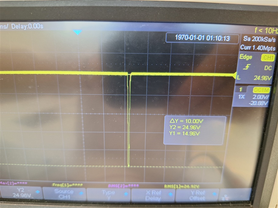

    6. It has nothing to do with the current problem of point 4 ... but I tried adding a load to the motor, but I get the error pMotor->tripFlagDMC |= 0x0002 given by:
    if( (pMotor->Vdcbus > pMotor->VdcbusMax) || (pMotor->Vdcbus < pMotor->VdcbusMin) )
            pMotor->tripFlagDMC |= 0x0002;
    I tried with Id_ref = 0, then Iqref = 0.05 and 0.1 etc. but the motor (after encoder alignment) accelerates quickly and goes into fault almost immediately.
    I also tried setting Vdc = 20V, 30V and 40V but nothing change.
    These are the default values I have:

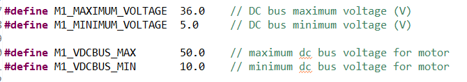

    In addition, I would like to ask you what the difference is between M1_MAXIMUM_VOLTAGE and M1_VDCBUS_MAX.
    This is the Vdc bus that I measure with the oscilloscope:

    • 6: MAXIMUM_VOLTAGE is legacy code, assigned to the unused variable voltageLimit in the motor object. Minimum voltage isn't used at all. The _VDCBUS_ parameters represent the actual upper and lower limits for the DC bus voltage before an error is flagged.

    Now, as for the error in (6), I'm going to say that it looks from the oscilloscope screenshot like the error is reporting accurately- your VDC shouldn't be dipping like that. Based on my prior experience and the context of the error, this most likely means that your power source is not currently sufficient to run the motor. High current draw and an unchanging maximum power means that your voltage is going to dip.

    Lastly, for Iq not following, try adjusting those parameters, like the guide suggests.
