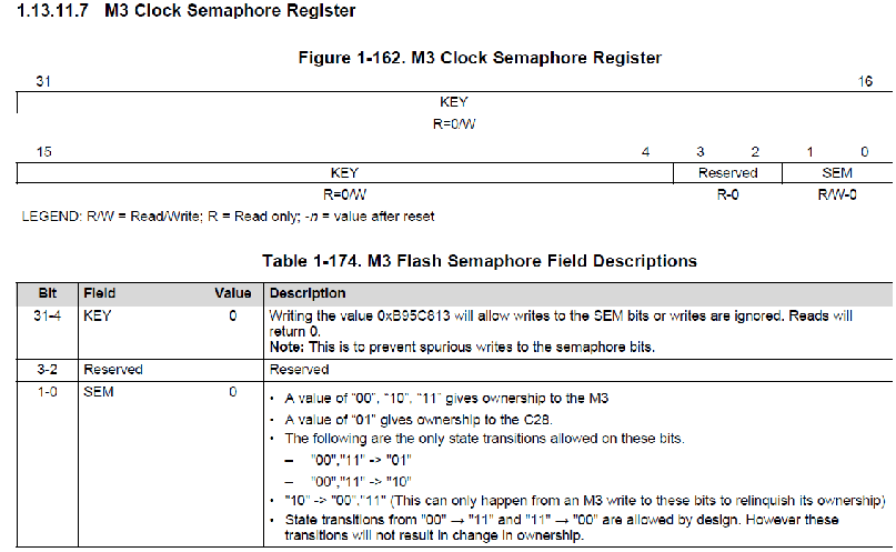

  • I am also trying to set clock from C28 and I cannot.
    Working with M35 controlcard using on-board XDS100V2, CCS 5.3, ControlSuite v160
    If follow procedure from TRM, from within C28 code EALLOW must be issued, then the bit #0 in CCLKREQUEST has to be  set to 1 before changing clock controlled registers. Also, in debug mode CCS via JTAG overrides this EALLOW bit in ST1 and JTAG has full access to all protected registers.
    Apparently, not: in any C28 sample project on breakpoint in debug mode the CCLKREQUEST is visible, but changing it is impossible - it ALWAYS reads as 0x00000000.
    Similarly, if running M3 project, on breakpoint in debug mode but changing MCLKREQUEST is impossible - it ALWAYS reads as 0x00000000.

  • Igor,
    when writing to the CLK semaphore registers you will have to write a KEY value along with the SEM bits. Please refer to the register description in the IPC registers subsection of system control chapter.
    Best Regards
    Santosh
  • Thank you, Santosh
    For everybody: magic KEY is 0xA5937EC0
    need to write a combination of 0xA5937EC0 +0x01 = 0xA5937EC1 to change ownership of registers.

  • Hi Steve,
    The register definition is in section "1.13.11.7 M3 Clock Semaphore Register" of TRM.
    Similarly for C28x, it's in section "1.13.12.7 C28 Clock Semaphore Register" of TRM.
    Vivek Singh
