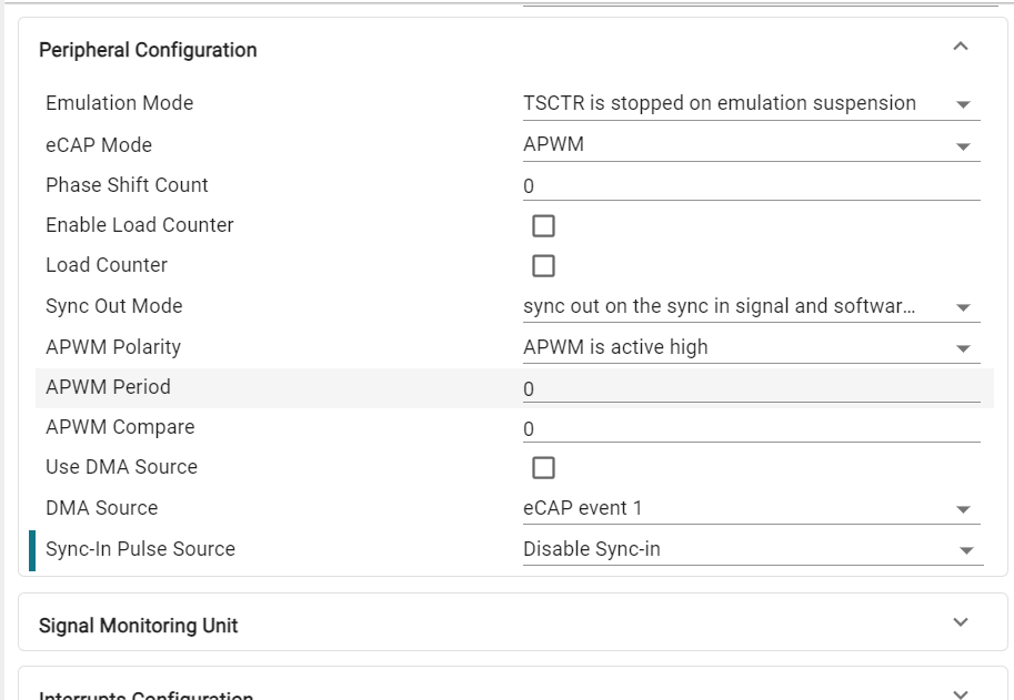

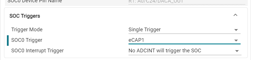

My customer want to configure the ECAP module work in APWM mode, and use it generate ADCSOC trigger
It needs to configurate in ADC and ECAP module in my understanding
But don't find the configuration in ecap module, could you help to check how to realize customer's requirement in sysconfig?

  • Hi Shuqing,
    This is missing in our SysConfig and I will file a JIRA to get this updated in the next F29 SDK release.
    The driverlib function to set this up is
    ECAP_setSOCTriggerSource(uint32_t base, ECAP_Events event
