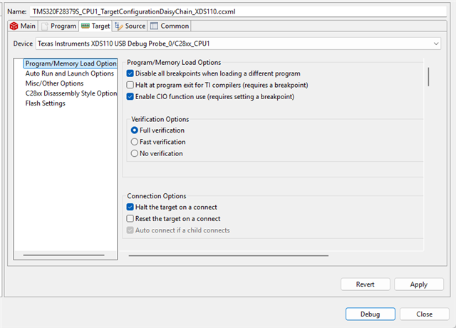

I chained the JTAG of two TMS320F28379S processors and then used dslite to program them.  Now I am trying to verify the code was successfully flashed.
Here is the dslite verification command and output:
dslite -v -c TMS320F28379S_CPU1_TargetConfigurationDaisyChain_XDS110.ccxml CPU1_TMS320F28379S.out
C28xx_CPU1: GEL Output:
Memory Map Initialization Complete
error: C28xx_CPU1: File Loader: Verification failed: Memory map prevented reading 0x007F00@Program
Failed: File: CPU1_TMS320F28379S.out: Load failed.
Here is the ccxml file ( I changed the extension so I could upload it):
TMS320F28379S_CPU1_TargetConfigurationDaisyChain_XDS110.txt
How can I fix the Memory map issue?

  • Ok, that also gives the same failure: C28xx_CPU1: File Loader: Verification failed: Memory map prevented reading 0x007F00@Program
    This seems to be the issue:
    .TI.memcrc
    * 0 00007f00 0000001e
    00007f00 0000001e (.TI.memcrc:_ccs_flash_checksum)
    That is what is probably causing the following warning that is showing up in the console: "C28xx_CPU1: Loader: One or more sections of your program falls into a memory region that is not writable"
    However, aren't the registers located in that memory region?
    0x7F00 is not in the C28x memory map for F2837 (mapped to the peripheral registers memory map, none of the device peripherals have program bus access).
    That's right, but they are not accessible from the program bus (and not in the C28x memory map) and are therefore not accessible to the C28x.
    Matt
    I don't think the CRC is causing the warning. Please refer to lines 75-79 in your linker command file:

  • I think I am close to fixing this issue.  I removed the register ranges from the linker command file and added the F2837x_Headers_nonBIOS_cpu1.cmd command file:

    As you can see in the linker command file, I added CRC_PRELUDE memory range for the crc.  In doing so, I had to move FLASH1_DO_NOT_USE2  outside of GROUP so there wouldn't be any memory gaps.
    However, when I link the code the following error occurs:
    <Linking>
    warning #10247-D: creating output section ".freertosHeap" without a SECTIONS specification
    "../EH/cmd/2837xS_FLASH_lnk_cpu1.cmd", line 77: error #10099-D: program will not fit into available memory, or the section contains a call site that requires a trampoline that can't be generated for this section. placement with alignment/blocking fails for section ".TI.memcrc" size 0x18 page 0. Available memory ranges:
    CRC_PRELUDE size: 0x10 unused: 0x10 max hole: 0x10
    error #10010: errors encountered during linking; "HMV_v3_FreeRTOS_CPU1_TMS320F28379S.out" not built
    I built it without the CRC_PRELUDE and I can see there is enough flash space for the CRC.  Therefore, why am I getting this linker error?
    Also, LAUNCHXL-F28379D: Running FreeRTOS project on F28379D launchpad - C2000 microcontrollers forum - C2000Tm︎ microcontrollers - TI E2E support forums  said that the freertos heap should be placed in the memory range 0x0000 to 0xFFFF.  I can understand the stack being in that memory range, but why does the heap also have to be there?  currently, it is being placed at 0x0047000 because the .freertosHeap section hasn't been defined.
  • 0x0047000 is outside the RAM range. Therefore, the .freertosHeap section needs to be set to a valid RAM range.  Does the heap have to be put in the range 0x0000 to 0xFFFF?
  • Here is what it actually shows in the map file for .freertosheap:
    .freertosHeap: load addr=000c7068, load size=00000004 bytes, run addr=00047000, run size=00000400 bytes, compression=zero_init
    .freertosStaticStack: load addr=000c706c, load size=00000004 bytes, run addr=00008000, run size=00001bf0 bytes, compression=zero_init
  • Ok, I think I fixed it. It now builds without any linker errors or warnings.
