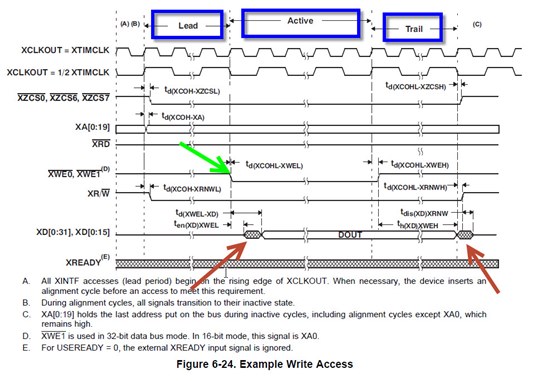

    I've been successful in writing to the XINTF. Now, I can monitor the XD lines with a logic analyzer, write to the XINTF, and show on the analyzer that I'm writing the value that I think I am. There is now one control detail I've had trouble in finding documentation on: How do I control the time delay between two successive write events?
    When I write two different values to the XINTF back-to-back, I can see that they are correct on the logic analyzer, but there are shorter time period values that show up between the two correct values that I write. These other 'junk' words are due to the XD lines changing values at different times after the first word is written. Is this common? And can including a time delay get rid of these other 'junk' values? What is the code in CCS for a time delay that I can control?

  • Jonathan Lee87033 said:

    Yes - refer to the timing diagrams in the data manual.(www.ti.com/lit/SPRS439)  I've taken a screenshot of a write access.  Notice that after the write strobe goes low (green arrow) the data lines will start transitioning (orange arrow).  Only then is it valid data.  Likewise at the end of the access the data lines will again transition to their inactive state (other orange arrow).
    A receiving device will likely latch the data at the end of the "active' stage - when the write strobe goes high.  As you can see the data is valid during this time and into the "trail" portion of the access.
    The lead/active/trail time can be configured - this is described in the reference guide www.ti.com/lit/SPRU949   I strongly suggest reading the reference guide descriptions before trying to understand the timing diagrams in the data manual.   The reference guide assumes a perfect case (no delays) so it is easier to understand the basic concepts and timings of lead-active-trail.
    No - there is no way to get rid of the transition.  There is a time when all of the signals are stable - this is described by the timing diagrams.
