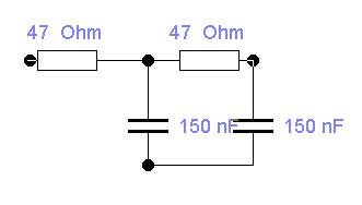

  • Hi Matthew!
    Everything is much easier! I have used the physical model of two-wire line. I knowed the parameters of my cable per unit length (the running parameters) from the cable specification and my technician soldered the physical equivalent on 40 km (from 40 resistors and capacitors 6765.1346.IMG0024A.rar, I did not consider the running inductive parameters because they are very small  in our case).
    Igor
  • Hy,
    Can you write the values of your resistors and capacitors, and upload a scheme of how you connected them please. I am interested of the equivalent of 1 Km so i understand u used it and multiply it for 40 Km. Your physical model is for low voltage ? Do you have values for medium voltage too ?
    But how did you managed the impedance and conductance ?
  • Hi Males!
    1 If you wish to create the equivalent of PLC then the best way to guide this 0172.TI_Channel_modeling.pdf. At this document for MV-cabel model:  L = 1.9e-6 H/m, C = 8e-12 F/m, R = 0.03 Ohm/m, G = 1.5e-6 S/m.
    2 Our case is very special. We are trying to use the cable for railway signals which have voltage ~40 VDC. The specification of this cable allows us to neglect L & G. So for example, our equivalent of 2 km looks as follows (resistors have power 40W):
    3 Going back to my point 1. Real power line consist many decupling equipment (some circuit breakers, the transformers etc). Therefore, in my opinion making a good equivalent of such a line is almost impossible. Testing PLC-modems is best done on the real power line.
    Igor
