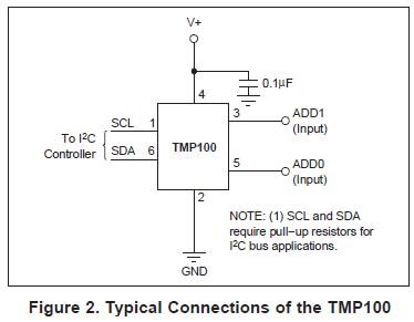

I have 2x TMP100 temperature sensors connected to 28335 .
They are working fine, separately, under different addresses, under interruption. I'd like to plug them together as multiple I2C slaves.
Now, since I am not polling, if I read temperatures of 1 sensor and then just following reading the other one, how can I know which one is answering first? What I mean is, although each one has unique addresses, if I don't stagger/alternate each sensor call timing, after the first one delivered his data, how I am to know for sure which one triggered ARDY interruption in first place?
Here is my code below, for just one sensor!

  • Thiago,
    I must be missing something.  I don't know anything about the TMP100 other than what is in the datasheet.  Does the TMP100 even have an interrupt mode?  Looks to me like all it has is an I2C bus and a couple of address setting pins:
    I'd think to read the TMP100, the F28335 I2C master issues commands to the address of the TMP100, and reads back the data as an I2C master receiver.  If you are using and interrupt signal from the TMP100 (somehow), can't you put the two TMP100s on different external interrupt lines on the F28335?
    David
    P.S. It is best to post long code as an attachment file, and not paste directly into your post.  Just a suggestion.
  • David,
    Thank you for your ready reply!
    I may have expressed myself not accurately. It is more of an I2C question.
    I was referring to interruptions being used in I2C module, in 28335 - which is always master, i.e., fifo_isr and basic_isr. You are right - TMP100 really doesn't have IRQ capability!
    To solve my problem of reading temperatures from each sensor I could simply command to the reading address and read back data from one sensor first and then repeat the procedure to the other. In my prototype, since temperatures change in slow rate, that would be ok.
    So my question is, if one needs to read temperatures of both sensors (for ex., to compare) with the shortest time difference between them, he could command the TMP's to read temperatures one after the other, instead of waiting for the first one to answer his call to command the other. Then TMP''s would work the closest as possible in time to each other. But how can I know which one answered?
    Let me show a quick time flow of my thought below.
    Set master transmitter:
    Start byte -> Slave address for TMP#1 -> command reading -> Stop byte
    Start byte -> Slave address for TMP#2 -> command reading -> Stop byte
    ARDY Interrupt :
    Set master receiver -> Read into 28335 RX FIFO
    FIFO Interrupt:
    update variable temperature  <- From which sensor??? Who answered first, since they were triggered very closely and latency could allow the second TMP to answer first.
    Can I do that?? Is it possible in I2C??
    PS Thank you for the long code tip!! I'll do that!
  • Thaigo,
    I don't think things work how you seem to be describing.  First, I think the TMP100 continuously takes temperature readings.  All you need to do is read the results of the 'Temperature Register' to get the value.  You don't command the TMP100 to take a reading.  Second, the TMP100 is an I2C slave only device.  This means the I2C master (e.g., the F28335) will completely control the bus and determine which slave talks and when.  The TMP100 does not "Answer" anybody.  Now, I am no TMP100 expert, so you may want to inquire on the appropriate TI support forum if there is still confusion that you cannot resolve after reading the TMP100 datasheet.
    So, the procedure to read the sensors will be that the F28335 does an I2C master-receiver transaction to one sensors (which gives the F28335 one temperature reading), followed by a second I2C master-receiver transaction to the other sensor (which gives the F28335 the other temperature reading).  The speed of doing this is limited by the I2C bus.  F28335 support at most fast-speed I2C, which means 400 kHz.  TMP100 supports up to high-speed mode (3.4 MHz), but the slower F28335 sets the speed limit (meaning, 400 kHz is best you can do).  According to the TMP100 datasheet, the sample rates are only 3 to 25 samples/sec anyway, so you're I2C transactions are going to be much faster.  You have no way to synchronize the samples on the TMP100 anyway (they run independently) even if you could read them at the same time over I2C.
    David

    TMP100 does continuous reading, or one shot readings. I am using it continuously anyway. When I say command reading, I mean what you said  "read the results of the 'Temperature Register' to get the value".
    You are absolutely right about all the rest and speeds! ;)
    That's what I wanted to know!
    It is working fine by now! :)
