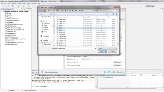

As Igor mentioned, the program is working in RAM mode; for it to work in standalone mode, you've to run in FLASH mode. For F28069 you can do it as the screenshot attached below:
