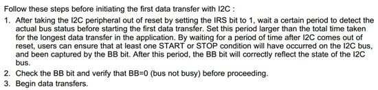

  • Hi Chandini,
    Are you following this procedure?
    Gautam
  • Gowtham
    Am following the same way i verified BB bit is 0 before proceding. my problem is no activity on SCL and SDA.
    as soon as the code is run, the SCL goes low and stays low. It's not pulsing at all. I'm not seeing SDATA doing any activity either. It stays as it is, high.
    if i check this after 1st data tranfer, execution stops at below line
    while(I2caRegs.I2CMDR.bit.STP == 1) { //// wait until the STP bit is cleared from any previous master communication
    whatever my big question is why am not getting any signals on SCL and SDA
  • Someone can help me please
