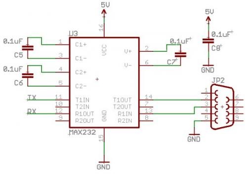

another question, I don't want to use virtual com port via mini usb interface, I've put S4 to DOWN and connected pin 3&4 of header J1 with COM port of my desktop via max232 (my max232 circuit works fine). I can't receive any tested character I sent on my terminal program in PC. Would I need anymore setup to complete this communication? (if connected via mini usb, terminal program can receive character as well). I know that max232 require TTL of 5v input, but TTL signal of c2000 is only 3v3, is that totally ok ?
    MAX232 level shifter circuitry is enough. 3.3V TTL works perfectly well with MAX232 IC and I've implemented the same. You don't need any other circuitry; just check the pulses using DSO. Also, the sample code in controlSuite is implemented for 9600 baud rate.

    In my project, it needs 115200 baud rate to communicate with the radar(can't change!), so that I've changed baud rate to 115200 in the sample code, I've tested output with terminal program(via mini usb port) that the code also works fine. Is that config ok if I connect J1.3& J1.4 instead of virtual com port ?
    Yes, J1.3 & 1.4 are perfect. Are you able to observe the data waveform in and out from MAX-232?

    So, your max232 circuit is working now or not? If not, can you share the max232 circuit schematic you're using?
    Here's a sample circuit that should have a common ground.
    Gautam
  • Hi Gautam,
    I'm working on a project that sends control signals to the transceiver, and receives data back to launchpad via COM port of this device. My max232 circuit is the same as yours, and it works well.
    With your helpful advices, everything is now ok and I can process data easily. It's my fault that I forgot adding a delay after each of my control singals so that the transceiver couldn't receive it (and so that couldn't send data back), launchpad and max232 all work fine when I observe their signal with a DSO.
