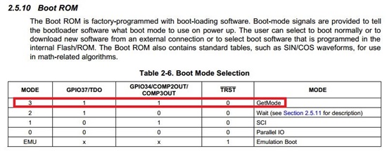

I have a design where I can run and debug the code using the CCSV6 and a Blackhawk USB2000 controller. So far so good. But I need to get the F28069 to boot from internal flash without using the debugger tools. How can I do this?
I am new to the CCS tool as well as the F28069 so the problem could be of a setup/config of the project. I have set and verified that the nTRST pin is '0',  GPIO34 is set to '0' and GPIO37 is set to'1'.
