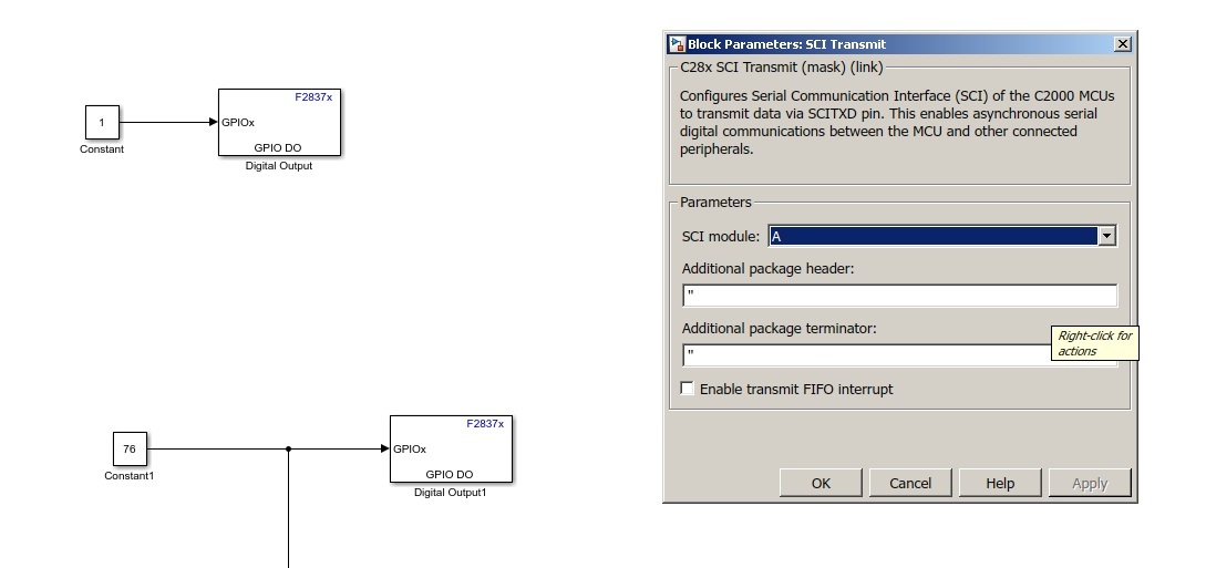

  • I am having problem with SCI programs with simulink and CCS, codes for both dont work
    I have tested with shipped in codes with c2000ware for SCI but dont work, used 28 and 29 pins for Rx Tx
    I having doubt about the usage of switch in launchpad, I used OFF OFF ON and ON ON ON
    The board I am using is LaunchXL F283779D
    I am attaching the screenshot for simulink models i have used and the CCS which I tested.

  • Vipin,
    Have you ever tried to send a simple one byte (uint8) character?
    Can you post an screen shot of the settings inside the SCI_TX block and inside the "Model Configuration Parameters"?
  • The second model is a simple constant value to the sci
    but its unit16
    I will send the screenshot of the configuration

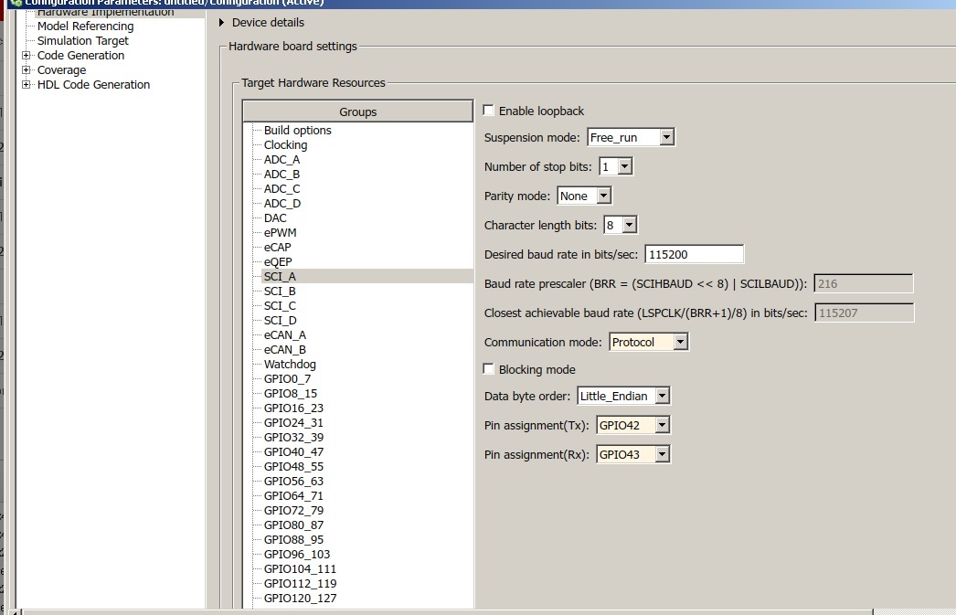

  • I have attached the screenshots of settings
  • The afore said simulink model now sends data to the terminal, but it is always 's'
    NO other character is shown what ever ascii value sent from the constant
    Please refer the following thread and the last part of conversation that talks about oscillator frequency settings and its impact on SCI_A operation. Hopefully the solution suggested in this thread is applicable here.
    Venkatesh Chilapur
  • Thanks for the reply
    It is working now, protocol selection was the problem
    I forgot to followup here sorry
  • Hi vipin,
    could you please elaborate on "protocol selection was the problem" so that we can have a learning as well.
    This will help us to bridge any gap from our side.
    Venkatesh Chilapur
  • sorry for the confusion, in this linked picture there is a option called protocol, I changed to Raw data, and now it works
    e2e.ti.com/.../SCI_5F00_configure.jpg
    My team member suggested me to do so, earlier I was busy thats why I didnt able to type this long

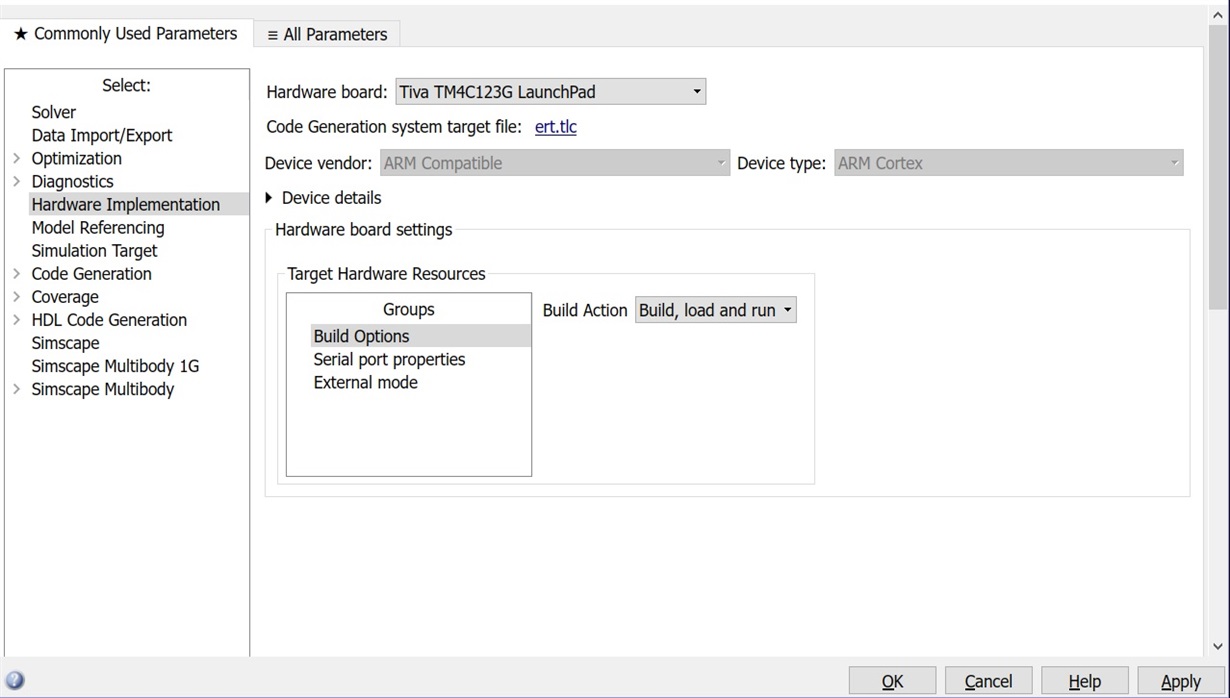

  • I got my LAUNCHXL-CC2640 SimpleLink Bluetooth which runs TM4C129 MCU. When I open the Simulink (2016b) "Model configuration Parameters" there is the hardware support for "Tive TM4C123G LauchPad":
    My first question is can I use these settings for LAUNCHXL-CC2640 SimpleLink Bluetooth with TM4C129 MCU?
    The TM4C129X and TM4C123X manual says these MCUs support CAN communication but I don't see any CAN communication settings when I select "Tive TM4C123G LauchPad":
  • Hi Kash,
    I don't think so - we don't have custom support for any of the CC2xxx devices.
    -Brian

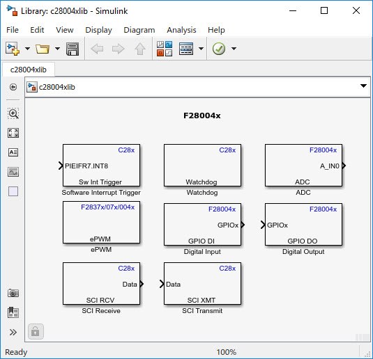

  • TMS320F28004X is supported by R2017b.
    I am very grateful.
    Samples of positioning control
    We are expecting greatly that the correspondence of the absolute encoder will also increase.
    It is even more amazing that Simulink Control Designe can also autotune using EmbeddedCoder.
    Thank you very much
  • MathWorks Release R2017b is now available for download. We've made some enhancements to our C2000 Support, which is a free download but requires our Embedded Coder product.
    Here are the release notes for C2000 in R2017b:
    • SPI Block Support: New SPI Master Transfer block and changes to C28x SPI Transmit and Receive blocks
    And as Hayaoki mentions, we now launched our initial F28004x support!
