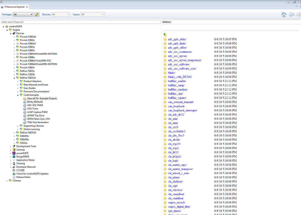

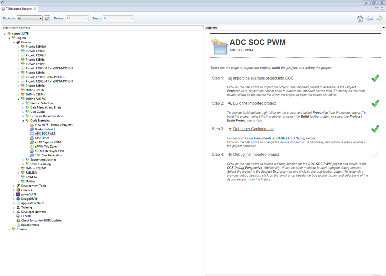

I am new to CCS and programming microcontrollers. I am using a TMS320F28337S launchpad v191 with CCS, trying to use some example projects in ControlSuite.  There is a very simple command that can be used through the research explorer to import, build, debug, and run these example projects if they are one of the few, initially view-able projects.
However, when viewing the 75+ examples, I must copy the source code directly and place it into a new project.
When I do this and debug the project I encounter fatal error #1965: cannot open source file "F28x_Project.h".  I also tried adding an include pathway directly to this file-

  • Hello Conner,
    Sometimes this can happen when you try to import projects from controlSUITE itself.
    Can you please try importing the controlSUITE project you would like to load directly into CCS?  Start inside CCS and then from the menu bar go to:
    Project >Import CCS Projects...
    From here you can use the "Browse..." button to point to the project's location.  For example:
    C:\ti\controlSUITE\device_support\F2837xS\v191\F2837xS_examples_Cpu1\adc_ppb_delay
    Your window should then look like this:
    Once the project is imported, try rebuilding it and then see if you can debug the project.  Let me know if this works for you.

  • Conner,
    Welcome to C2000!
    Yes, the resource explorer only has a few examples (the ones with blue CCS folder) that can be imported and built through the GUI. Viewing all the projects is there to list what other projects are available and those need to be imported through CCS via the method Billy mentions above.
    Importing them into CCS and not copying them into the workspace will clear up the build issues.
