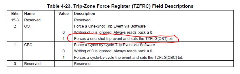

Trip Zone Software Force on F28335
Looking at the manual for the ePWM block, sprug04a page 107, states that the bit, TZFLG.OST, is set when a trip occurs on a configured pin selected as a one-shot trip source. My question is that also the case, the bit is set, when a software force is done only? I would like to tell the difference between a software forced trip event verses one generated externally on a configured a pin.
