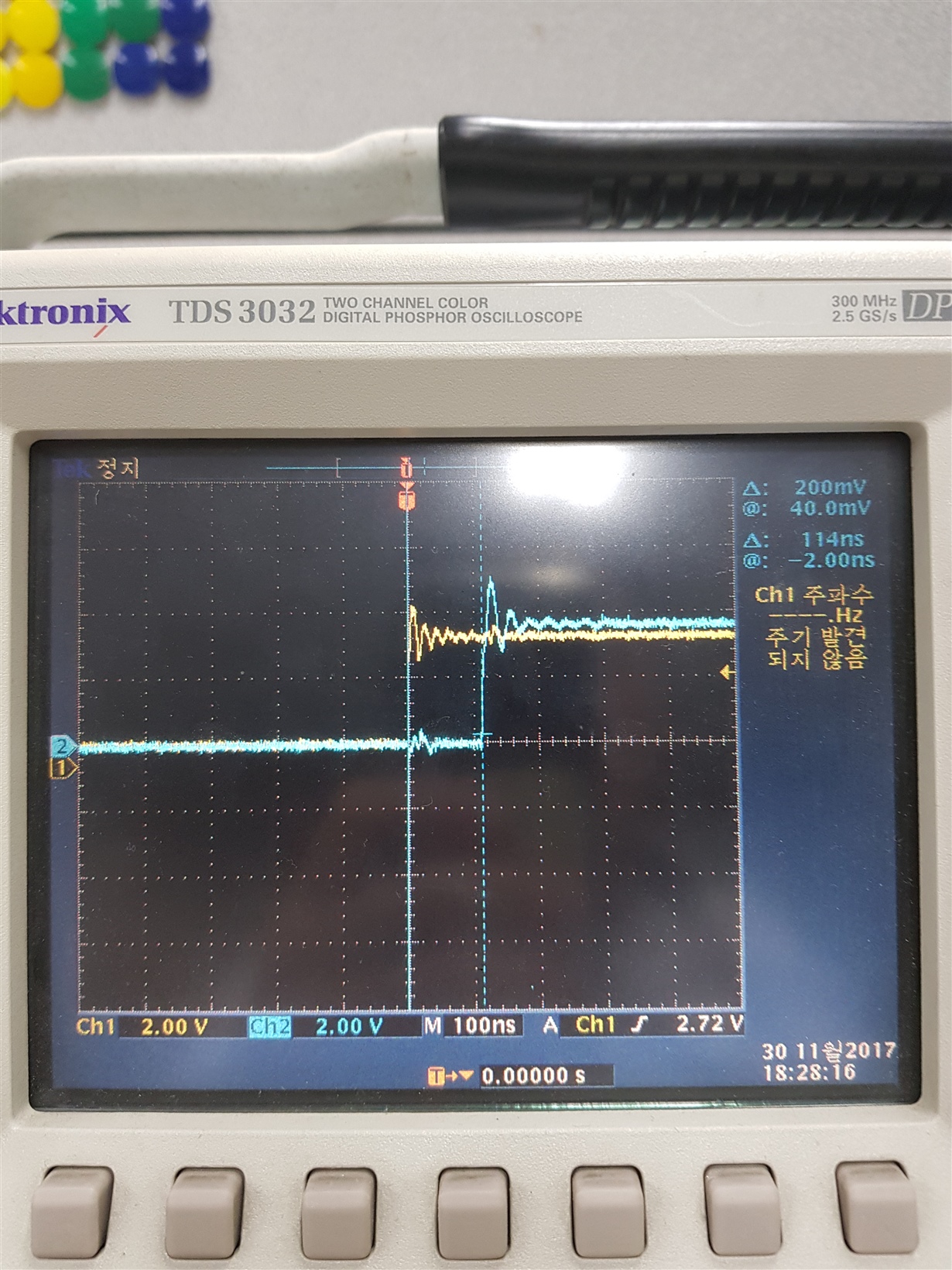

I'm testing ePWM ISR using epwm_up_aq_cpu01 example.
I added GpioDataRegs.GPATOGGLE.bit.GPIO1 = 1; in the first line of the epwm1_isr to check interrupt latency.
because TRM says "The minimum interrupt latency is 14 SYSCLK cycles" so I expected 70ns+ latency.
When I test with default clock prescaling setting as below, it shows 110ns which is very reasonable.
   EPwm1Regs.TBCTL.bit.HSPCLKDIV = TB_DIV2;   // Clock ratio to SYSCLKOUT
   EPwm1Regs.TBCTL.bit.CLKDIV = TB_DIV2;
But when I changed clock prescaling value as below, interrupt latency is increased to 176ns.
EPwm1Regs.TBCTL.bit.HSPCLKDIV = TB_DIV1;   // Clock ratio to SYSCLKOUT
        EPwm1Regs.TBCTL.bit.CLKDIV = TB_DIV1;
Why is this happen?
I measured rising edge of the PWM and GPIO toggle time.
Ted
