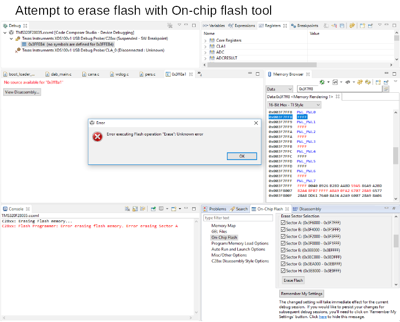

  • Hello Manoj,
    I am attaching the screenshots requested. Please see below:
    (Sorry for the white spaces)
  • Mathias,
    Address locations in bootrom you mentioned 0x3FFEB3 and 0x3FFEB4 actually belong to Flash API delay function called Flash28_Delay. It looks like device got suspended in middle of executing flash api function. So, you don't need worry about seeing 0x0000s in flash during this time.
    Based on the snapshots it is clear that device is in unlocked state and your individual flash sector is in depletion.
    Regarding the CCS error message, try just erasing one flash sector at a time by disabling other sectors. Mostly likely you should be able to erase / program other sectors.
    Manoj
  • Hi Manoj,
    I did try erasing flash sectors individually. None of them can be successfully erased. Same error is shown for each case. This is the strange part since the device is not locked.
    Is there any way to configure the time for the Depletion Recovery tool. I wouldn't mind leaving the process running for as long as it takes...
    Matias
    Attaching this image as proof:
  • Matias,
    No, there is no way to configure time of depletion recovery tool. Your only option is to replace the part.
    Please make sure not to halt the flash program / erase operation to avoid such situations.
