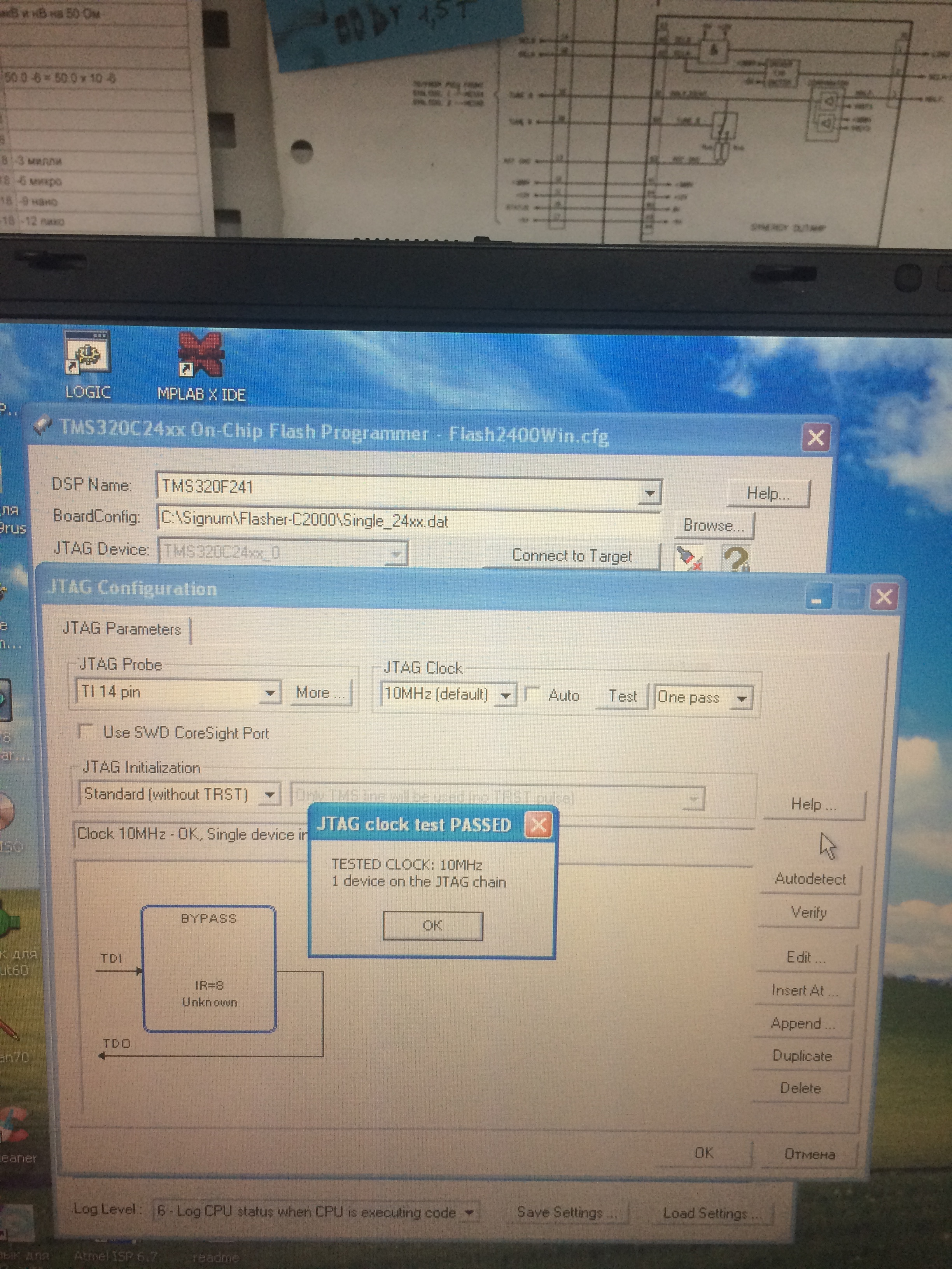

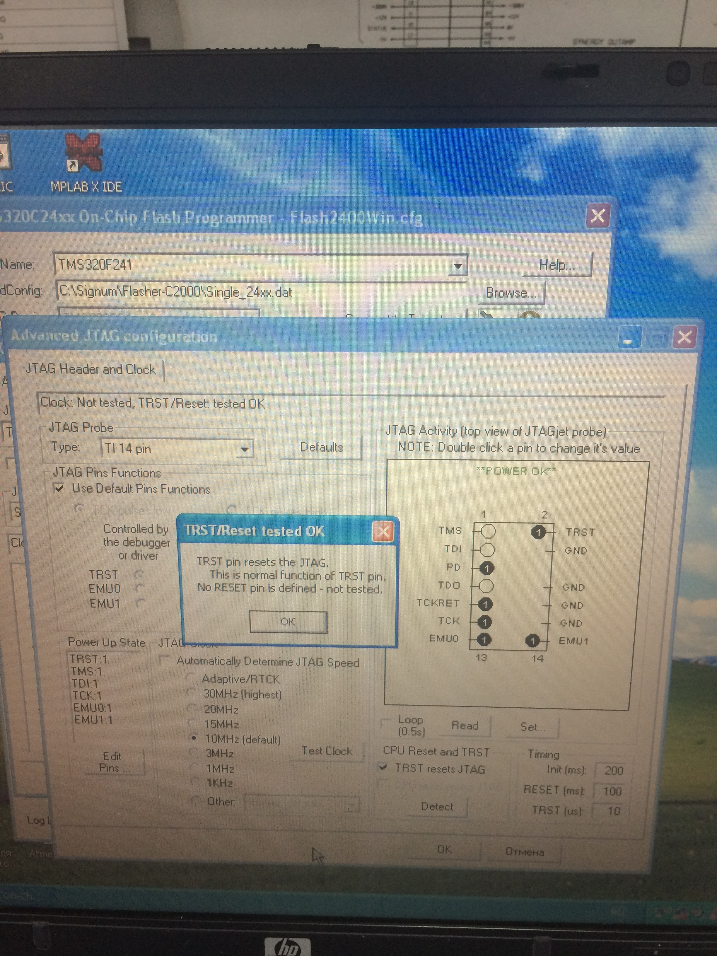

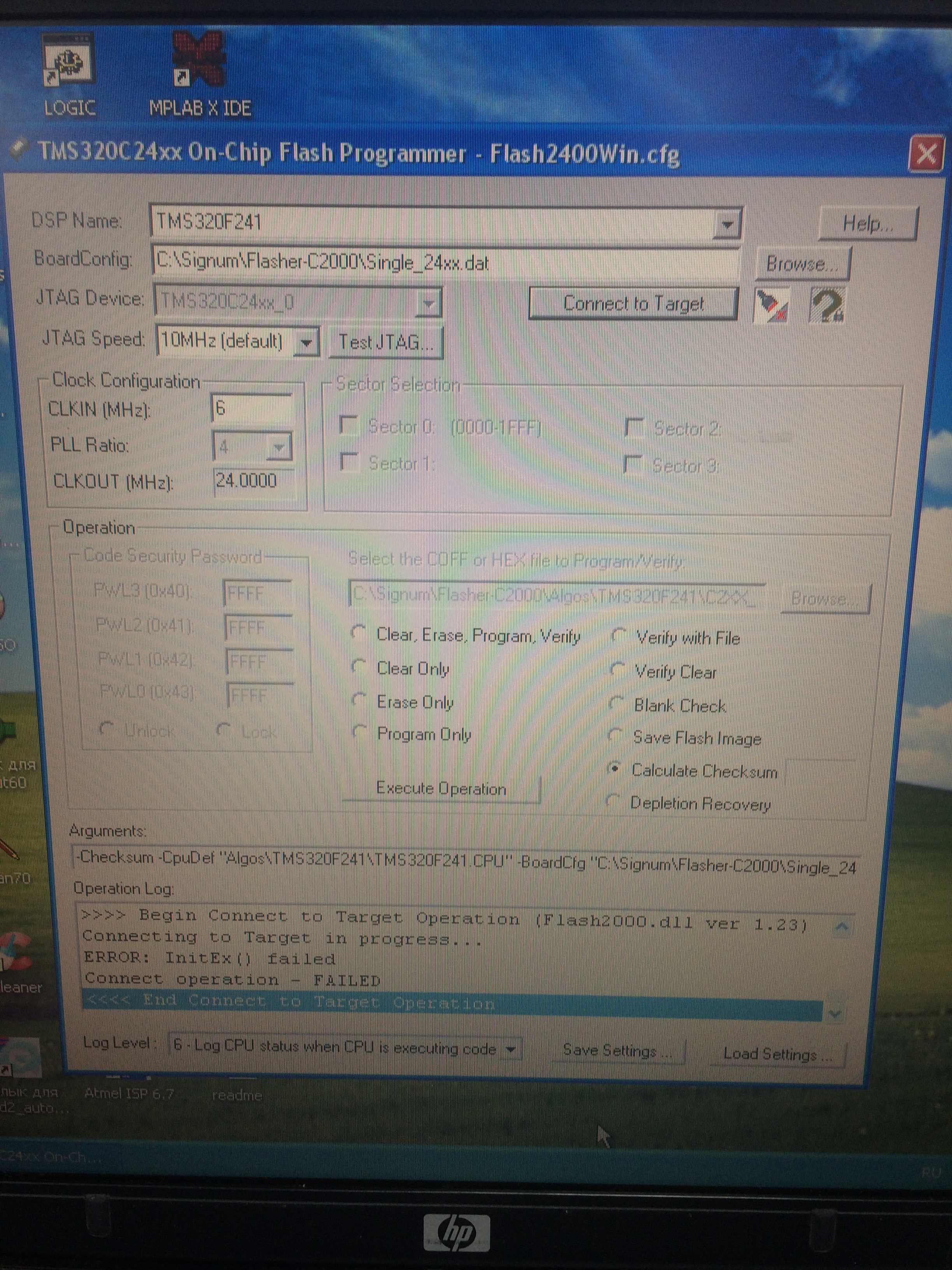

Hello all there, I`m need help. I tried the read checksum and did same other operations for used DSPs TMS320F241FN we bought. But Flasher-C2000 (Windows XP) don`t connecting to target and propose to try the steps to fix the problem.

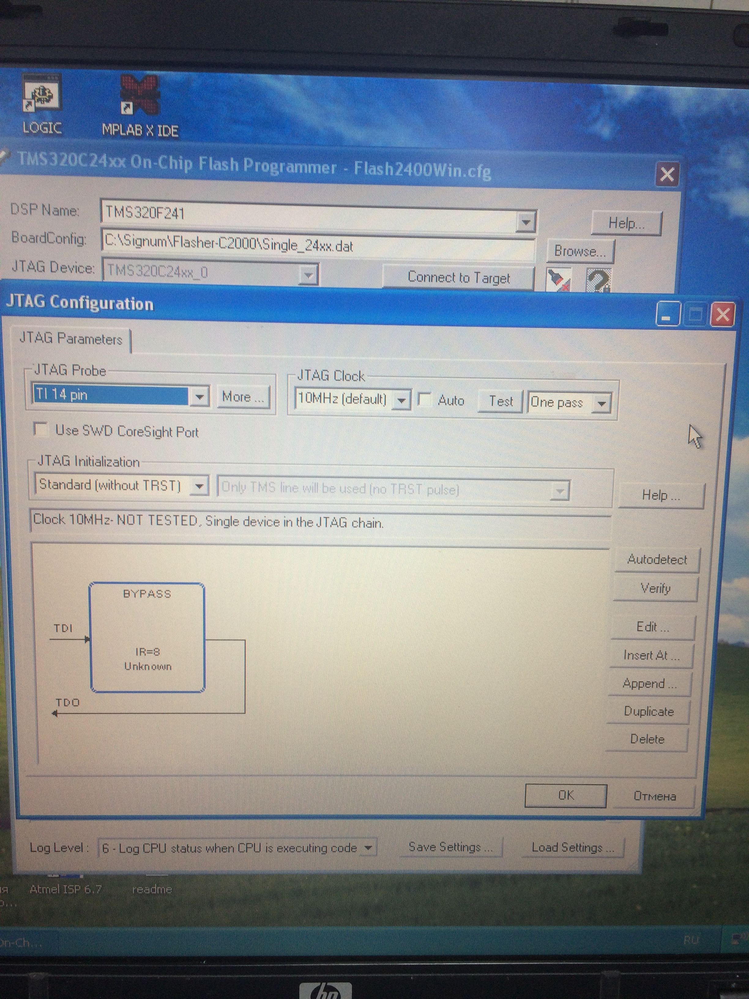

- Probe selection matches the JTAGjet probe.
- Tried all JTAG clock frequency.
- Disabled the on-board buffers on the JTAG lines.
- All resistors are in  recommended range.
- JTAG connections on the target.
Please help, troubleshooting can`t do it.
  • We need more details in order to be able to help you. What we need to do is to isolate the problem to one of these entities:
    Your hardware:
    Is this a known good H/W?
    Is this a new design or a design that has been in use for a while?
    Have you tried connecting to another board?
    Your debug probe: Have you been able to connect to a known-good board using the debug probe?
    The F241 device: Have you tried connection to more than 1 device?
    The software: Are you able to connect to the target using CCS3.3?
    You may be aware that TI announce EOL (End-of-Life) for this part in 2012. Support for this part is very limited and the entire tool-chain is now obsolete. Please answer all the above questions clearly and we'll do our best to help you.

  • Hardware and debug probe: What means is "hardware"? If this is the DSPs i tried to read i don`t know it`s status, we used has been bought on ebay DSPs or has been in use.
    This is not board, but DSP connected to JTAGjet via ISO-TI-14 debug probe. I tried connect to same other 241 DSPs.
    The F241 device: No, i tried connection to 1 device only.
    The software: i don`t tried connect to the target using CCS3.3. Can i read the hex files or checksum from DSP via it?
  • By "hardware", I was referring to the board on which the DSP is mounted. From your post, it appears there is no "board" as such, but a flash programming adapter. Would you be able to provide a photograph of your setup?
    It is important to ensure your debug probe is able to establish a connection with the DSP. It is for this reason I suggested you do it with CCS3.3. Once you establish a connection, you would be able to read the Flash contents (which may be hex files or checksum).
    On a different note, if the device was not bought from a TI authorized distributor, establishing the health of the device may be challenging. You also need to be vigilant about counterfeit devices.
  • We absolutely need to ensure that the JTAG debug probe is able to communicate with the device. Meaning, there are no hardware issues. Unless, this is done, it would be a waste of time trying to debug the flash programming issue. The easiest way to do this is to connect to the device using CCS3.3.
