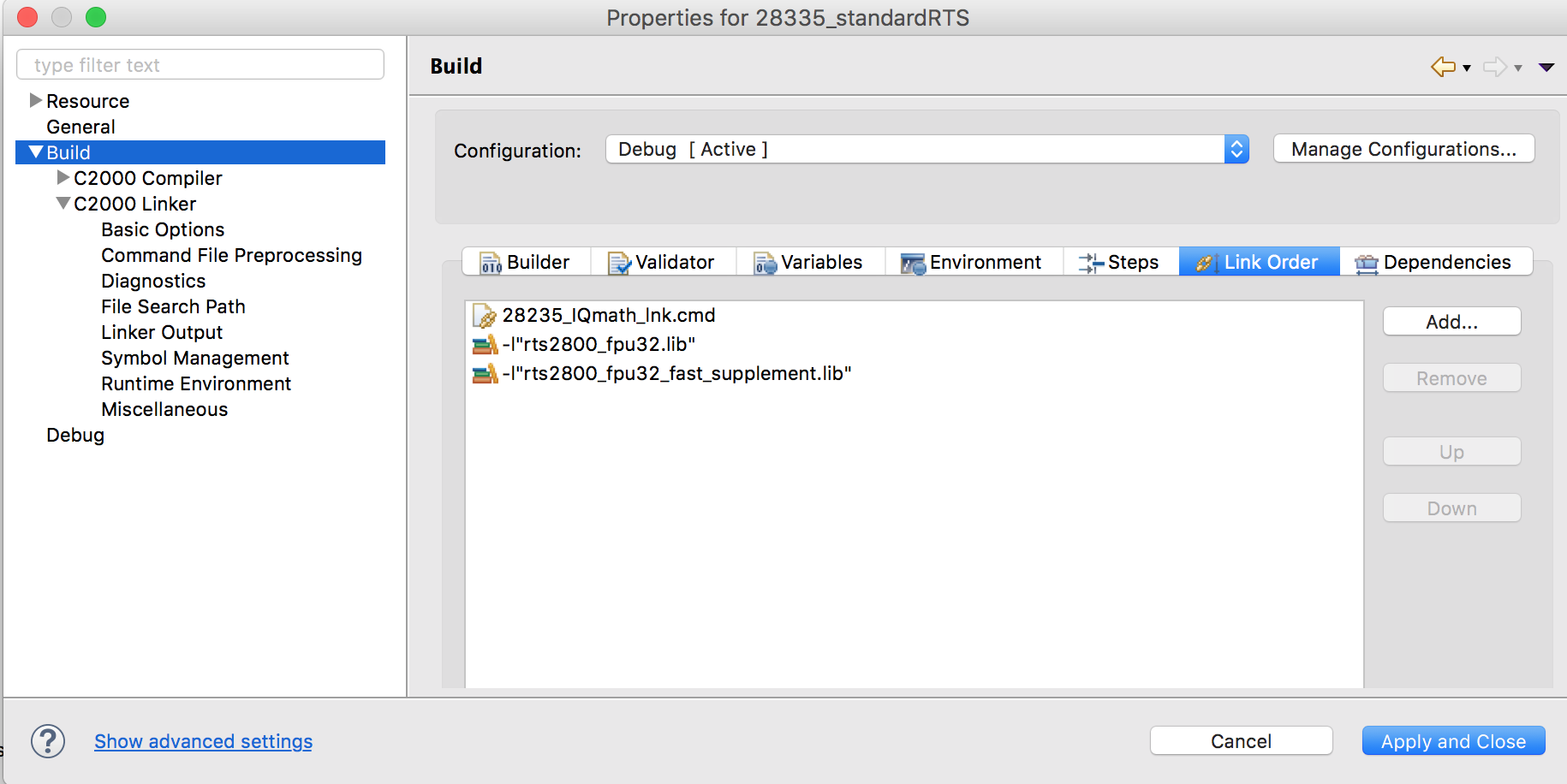

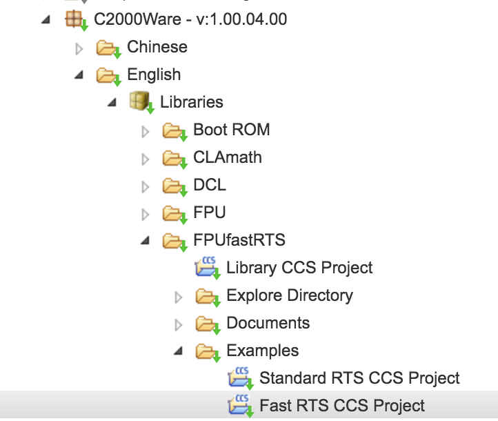

  • I will need to loop in someone from the C2000 team.  Note that there are examples fro Fast RTS in C2000Ware.  I just tried importing them and they are building ok for me.  One thing I noticed is that the "standard RTS CCS Project" in Resource Explorer imports the Fast RTS project and the "Fast RTS CCS Project" imports the standard one.  I will file a bug for that.
    However if you import both of them you can compare the build options, specifically the link order.  The capture below is for the Standard RTS project and you can see that the regular RTS is ahead of the fast one.  In the Fast RTS project it is the reverse.
    As far as 28379D support I will need to differ to the C2000 team.  The examples are for F28335.

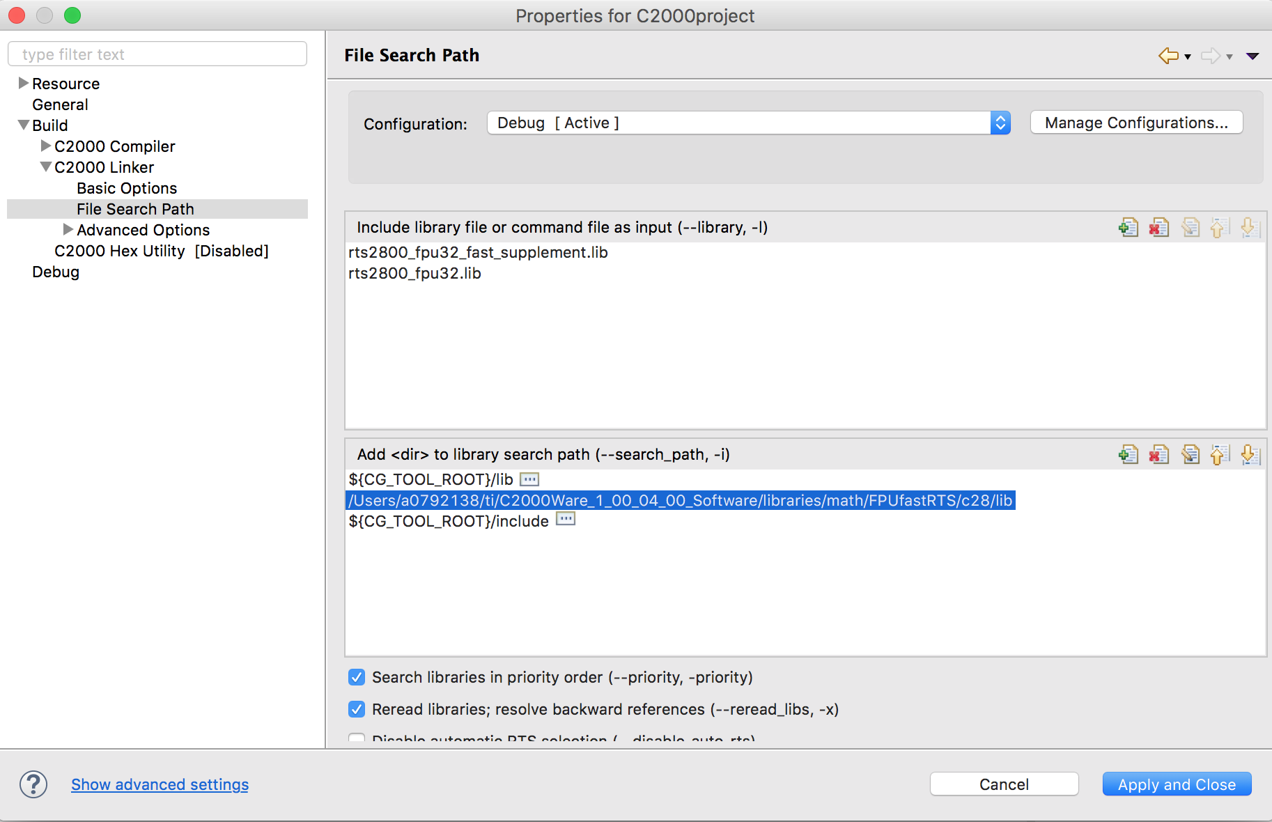

  • I spoke with a C2000 expert and they were not aware of any reason why this library would not work with F28379D.  You should be able to apply the linker build options and link order settings from the example.
    I have done this in a project myself with no issues.
    First I have modified my linker options to look like this.  You can see the 2 RTS libraries I am including and the order shown.  Below that you can see the search paths.  The key thing here was to add the path to where the fast RTS library is.  And then note the 2 options set at the very bottom.

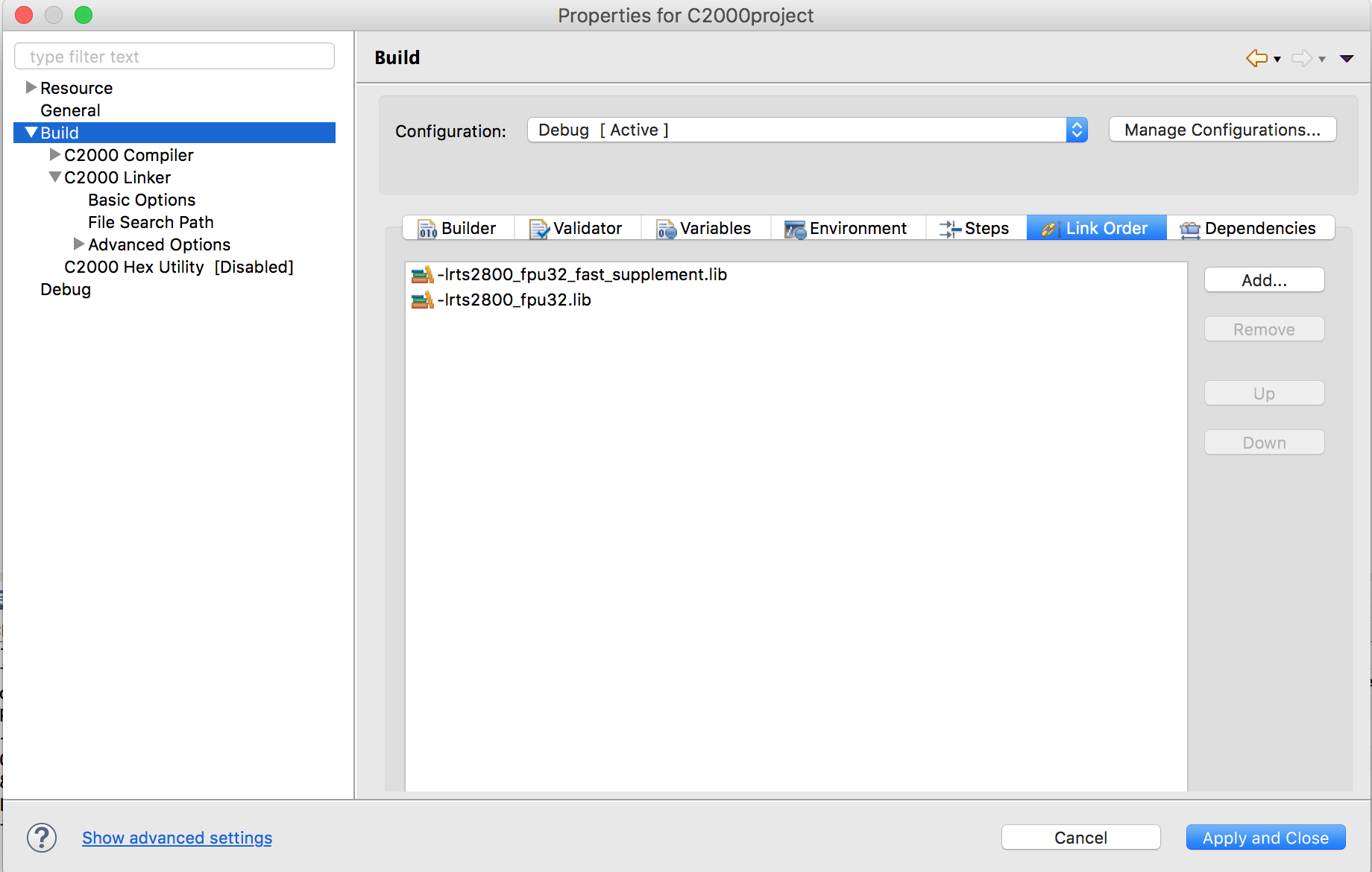

    Next I made sure the link order has the supplemental library prior to the regular RTS library.  I had to click the add button to add them both.

  • John & Manish,
    I found the source of the linker error. It is the "pow" function. Whenever I use SFRA (with SFRA F lib) and pow function together in a project, I get the "sqrt redefined" linker error. I get this error even in a new and clean project.
    If I change pow to powl, it is working. powf also does not work.
    FYI.
