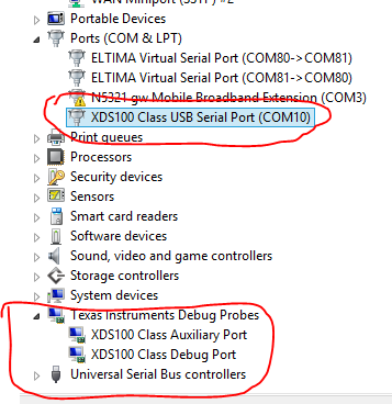

Hello everyone,
after three days of reading all I can find and still not solving the issue I must seek for help :( :( :( :(
I am unable to connect with JTAG (on board F28M35XX control card from experimental kit) to the board itself.
Tried test connection and it fails with:
[Start: Texas Instruments XDS100v2 USB Debug Probe_0]
Execute the command:
%ccs_base%/common/uscif/dbgjtag -f %boarddatafile% -rv -o -F inform,logfile=yes -S pathlength -S integrity

And device manager looks like:
  • Nikola,
    Thanks for reaching out to the E2E and thanks for the initial pre-work, it should speed up our debug process.
    From your screen shots, the PC is seeing both the emulator(XDS100v2) as well as the secondary UART port so we know the FTDI chip is good.
