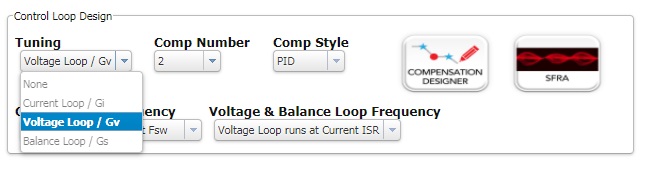

2/ In the .cfg sheet, we can choose between 4 builds. Does each build is independant or do we need to configure all of them for using build 4 ? I am asking this because I can't choose loop with the scrollbar menu :
If I want to configure voltage loop I have to choose build 3, idem for Gi and Gs with builds 2 and 4.
3/ Like the question 2, I can't change neither "Comp number" nor "Comp style", I don't know why. Moreover In build 2, with a P correcter I have also a Ti coeff in the compensator designer and in build 3 I have no choice to use PID (different from the documentation ...maybe it's another version) :
    Jeremy, yes that is correct, we want the user to incrementally build the system and hence only allow changing one loop at a time which is determined by the build level. At least for the vienna rectifier solution, this is the safest method. For some other solutions, we do allow tuning more than one compensator at a time.
    Jeremy, does not look like you are on the latest version of this software. Please note we recently updated this solution in C2000Ware DigitalPower SDK, please use that solution to base the question as that is the maintained branch of the solution. Yes, we do restrict the no and style based on the type of solution it is.

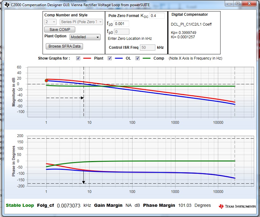

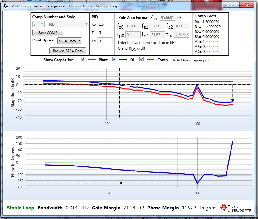

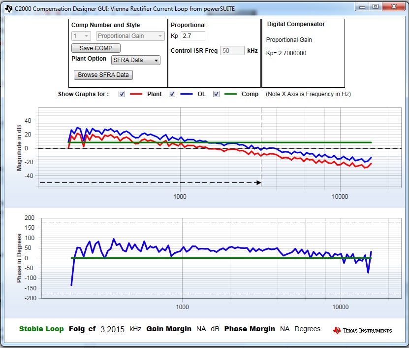

    This SFRA result for build 2 with my system :
    I think this is not bad, this the modelled system for the build 3 :
    It's exactly the same than documentation.
    Changed parameters are output Cap Co = 220µF (on the board), outputVbus = 450 V (for beginning) and operating power = 698W in accordance with my 290ohm load.
    When I am clearing PWMtrip, I can heard the power increasing very fast then an trop occur (probably in current). Can you give me advice or way to study please ?

    To be honest, I will recommend first simulating with all your gains etc, to verify if it's stable in simulation? Have you tried that?
    Also for the current loop, you only have propotional gain ???
    Also, i would check offsets in the current sensor, is this new hardware? do you run calibrartion routine? I have seen those offsets if they are too mych to slowly add up and make the bus unstable. If you have PI loop it adds up much faster.
