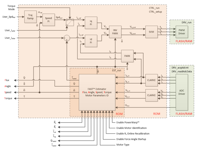

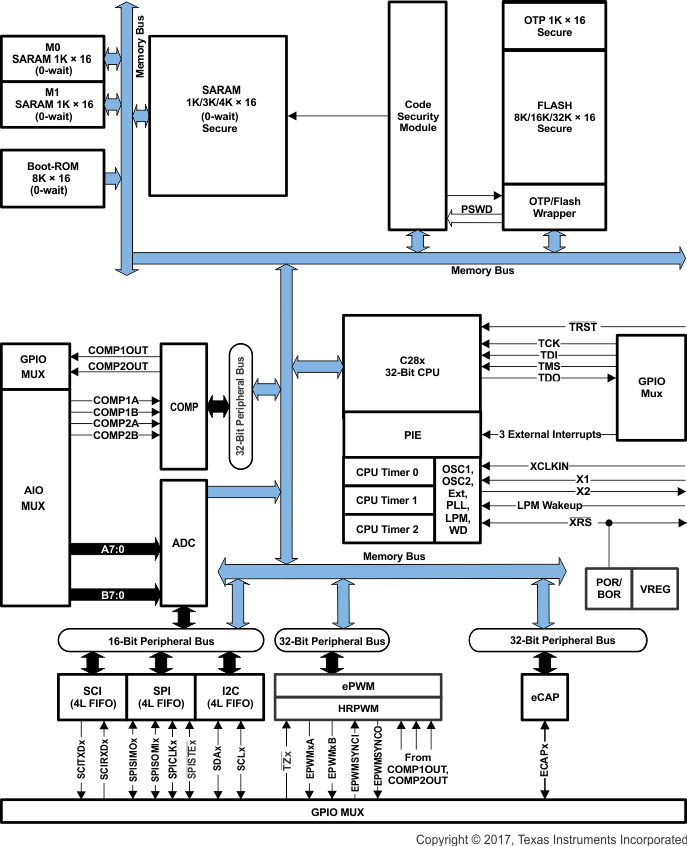

I just want to wonder where does the FAST Estimator (Fig.1) stored in the TMS320F28027F (Fig.2). I didn't find any other ROM except boot ROM in the architecture of Fig.2.
Figure 1. InstaSPIN™-FOC implementation from ROM memory
Figure 2. TMS320F28027F - Functional Diagram
