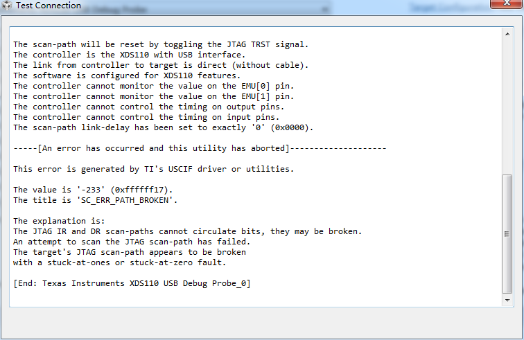

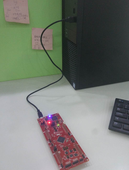

My customer is using CCS8.2.0 and LAUNCHXL-F280049C.

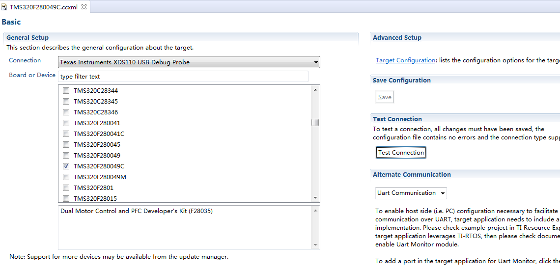

The setting is as below: and then click test connection.
Get the result:
Part Number: LAUNCHXL-F280049C

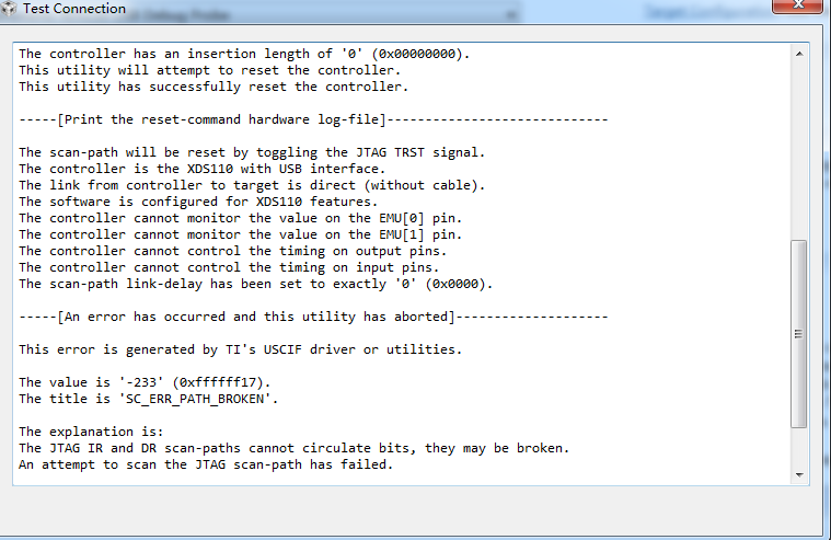

Get the result:

I would recommend taking a look at the LAUNCHXL-F280049C user's guide - and specifically question 3 within the FAQs of its appendix.
http://www.ti.com/lit/spruii7
My guess is that the target configuration has not been edited to use cJTAG mode, yet.
Hopefully this helps!
