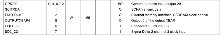

In the Pinmux tool "dev.ti.com/.../app.html" the EMIF1 SDCKE can use GPIO29 and GPIO 117
In the Datasheet Em1SDCKE is only avaliable on GPIO 29 "http://www.ti.com/lit/ds/symlink/tms320f28379d.pdf"
Is there a error in the Pinmuxtool?
Can i use the GPIO 117 for the EM1SDCKE?
Do i overlook something?
