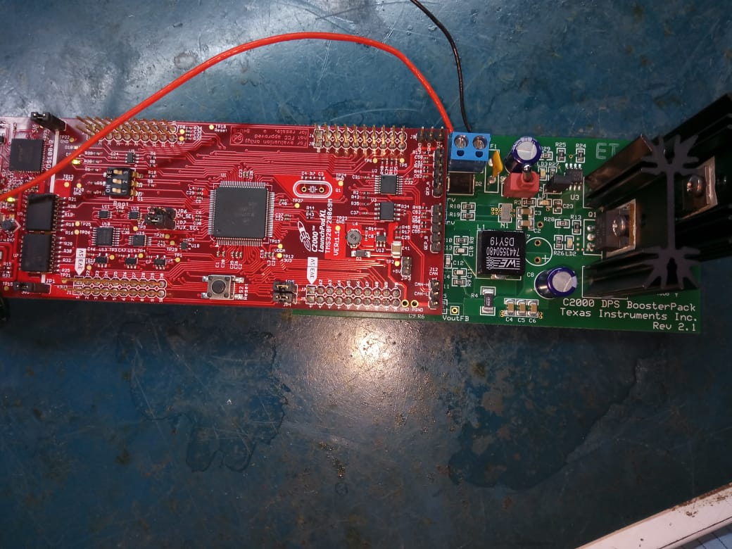

I am using TIDM-DC-DC-BUCK(http://www.ti.com/tool/TIDM-DC-DC-BUCK) Converter with LAUNCHXL-F28069M.

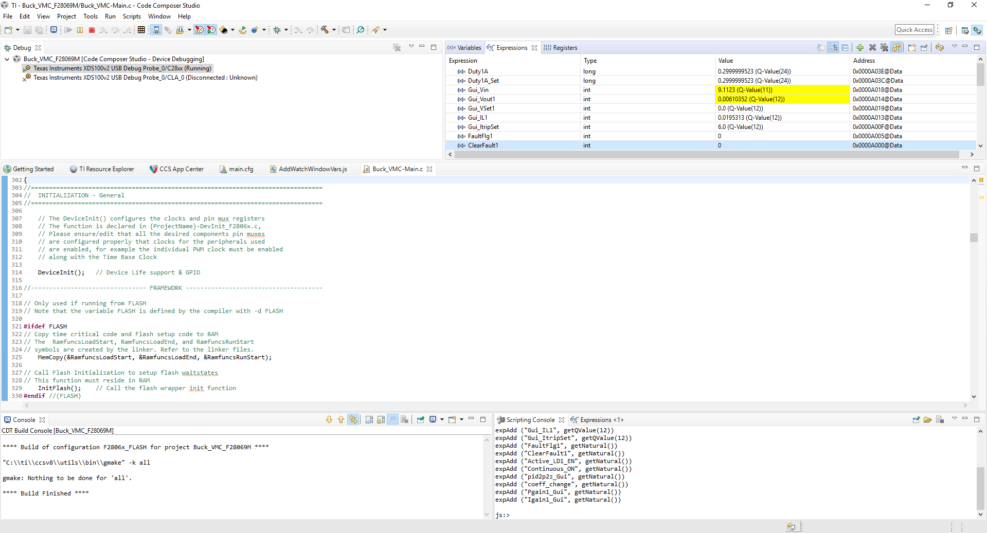

When I am at Step 2 turn on the 9V supply, I am getting 9V at expression window. before turning on the switch SW1.

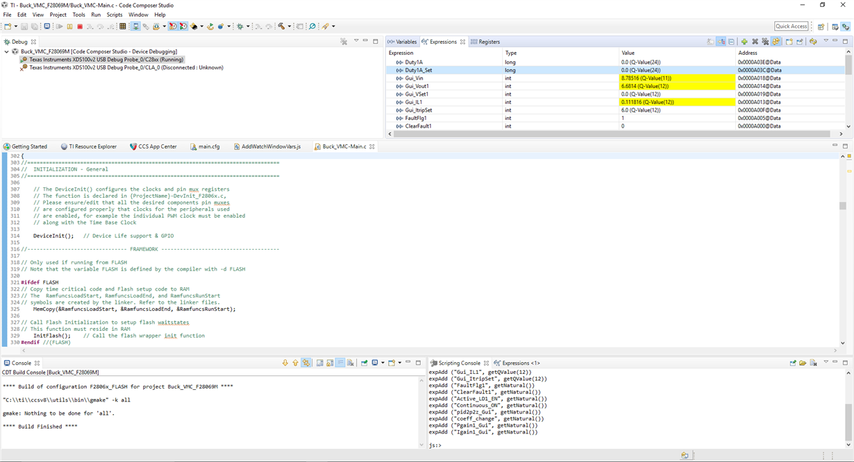

But, when I am turning on the Switch SW1, I should get almost 0V because my duty is 0 but I am getting some 6V at output.
Input voltage is also dipped to 8.7V and load resistance (PR1) getting heated. FaultFlag has been set to 1.
it looks like something is shorting. But this is the first time I am using the board. How that is possible?
I have checked the PWM pulses at PWM4A and PWM4B. Both are zero. but still output is comming 6V.

    After analyzing the waveform, I came to know that even though I am not connecting Launchpad (No PWM Control pulses) some DC voltage is coming.
    Then I have observed the SW node voltage. It is also same as output voltage. From this we can conclude that the upper switch is continuously turned on.
    And Output of driver also high. So it could be Driver or MOSFET problem. One more thing I would like to suggest that in the schematic the Vdd supply of the Driver IC is mentioned as before Switch SW1 but actually it is after SW1. You can correct it.
