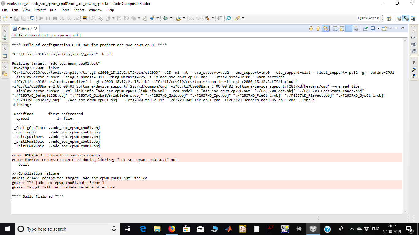

When I am trying to build adc_soc_epwm example, I am getting compilation failure. However other examples are running fine. I have attached my console log and code files.

  • hi ,
    I see you are using APIs like ConfigCpuTimer(&CpuTimer0, CPUFREQ_MHZ, 1000000.0/samplingFreq_hz) ,  InitEPwm1Gpio();  etc  ..
    I don't see the respective .c files included in the project .
    This error is seen since you are calling the APIs that are in the .c but its not included in the project but yet called in main file.
    Please add the files like F2837xD_EPwm.c & F2837xD_CpuTimers.c as needed from
    C2000Ware\device_support\f2837xd\common\source
    Regards.
