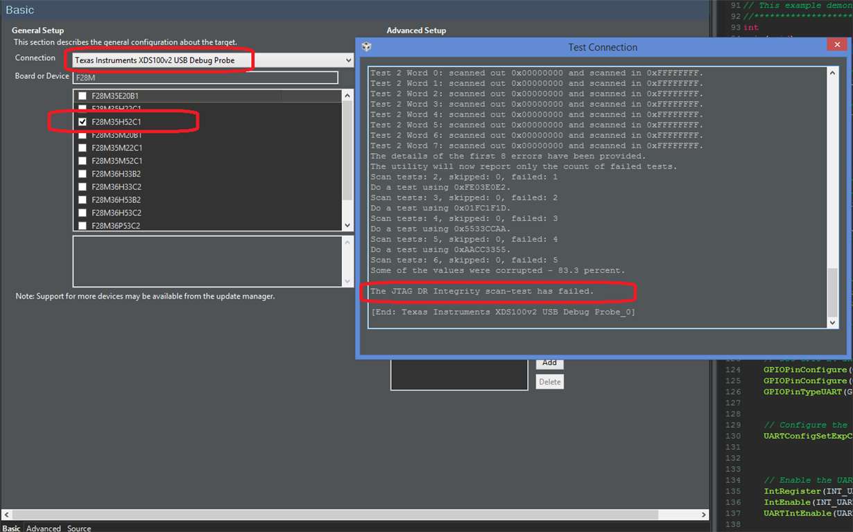

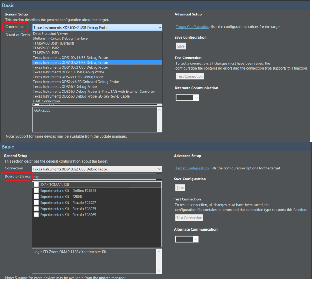

I am trying to use H52C1 Concerto Experimenter Kit ( TMDSCNCDH52C1 ). The Experimenter Kit I use does not seen at Target Configuration. I using together Experimenter’s Kit USB Docking Station with TMDSCNCDH52C1.
. Which ones should I choose in Target Config?
CCS IDE Version: 7.0.0
Screen shot is below. Can someone help me, please ?
Best Regard,
UFUK
  • In this case please use the device F28M35M52C1 from the drop down, as this is the C2000 MCU on the experimenter kit you have.
    I'm not sure why the experimenter kit is not listed(I don't see it on my install either), but using this device will give the same results as selecting the board.
    I'll look into the latter to understand why we show some and not others in the drop down.
    Matthew
  • As you said, I've loaded XDS100V2 driver, after I have chosen F28M25H52C2 and tested connection, but the result is same.

  • When you run the "test" from the Target Config window after you powered the base board(LD1 is now lit) was the output different from before?  There shouldn't be a reason to change the passives on the PCB at this time.
    It may be helpful to refer to this app note: http://www.ti.com/lit/spracf0 in terms of debug steps.  This will help us get on the same page; i.e. if you go through the app note and can say I got to step X.X then it will help to narrow down the potential issue.
