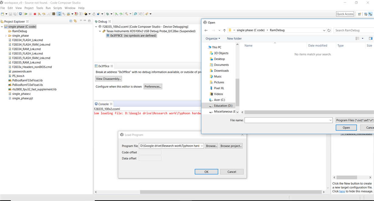

        I have made a schematic in PSIM, generated its C-code and using CCS to burn it into my TMS320F28335. However, the ram debug folder is empty., so that I am unable to see any .out file to load into the controller.
Can you please guide how the .out file is generated??
Thanks.
  • As can be seen, the ramdebug folder is empty. Maybe there is some setting to generate .out file that I am missing. Thanks in advance.

  • Thanks Whitney for your reply. I have tried build project by all ways you told me but the .out file is not there.
    I have created the overall schematic in PSIM and built the project using PSIM generate code option. So, all these files have been created by PSIM.
  • Unfortunately, I'm not very familiar with PSIM so I don't know what kind of code it generates. Did you get any error messages when you tried the build? Anything show up in the build console?
    What if you create your own CCS project by going to File->New->CCS Project and then add your PSIM code to that project? The project you have in your workspace currently is just a generic C project which I imagine isn't going to be setup by default to use TI compilers.

  • You are right. There are errors. See below:-

    Can you give me some directions how to proceed in this case?
    I am not using my own code. Its the code I get from PSIM working model. The syntax errors are there that need to be removed prior to build.
  • Hi Whitney,
                      The issue was with a bug in the psim version I was using. Now its resolved. Thank you for the efforts.
