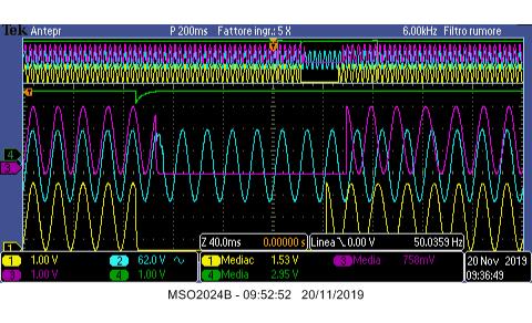

    Probably, the reset issue is caused by EMI noise when I start power section with common mode noise that can recirculate if 2 power device are in parallel relatively from AC and DC power rail of system.
    Unfortunately, I said there wasn't an external reset when it occured: how you can see from follow screenshoot I monitored XRS_ [CH4] pin during reset event and this fall down for a short period and then it rising up immediately; maybe, in the past, I didn't catch this event because my LH trigger level it was too lower.
    Moreover, I don't can put any breakpoint to interrupt power synthesis and anyway I don't understand how can I obtain any information from breakpoint if I lost emulator control caused by reset.
    In conclusion, I filtered better VDDcore DSP power rail: before I had 22u after onboard DC/DC [TPS62420] followed by LC filter [bead + C = 10u near DSP]; now I replaced last 10u with another 22u. So far it seems a good solution: is one day that the reset event is disappeared!

  • Hi Vivek,
    This morning the reset event is coming! :(
    I attach some oscilloscope waveform:
    From CH3 you can see reset activity during PFC starting task [CH2]: how it's showed I'm working, for now, at low voltage [in the past, I reached voltage up to 800Vdc]. Today the reset issue is coming when only PFC [loop is running on CPU1] is started [inrush event + soft-startup + steady state was interrupted!].
    If you look at screenshoot, where XRS_ pin is zoomed, you can see that it fell down for 520mV and than traced back in about 16ms related to reset capacitor [in the past I had pull-up 2k with 100nF -> now Cres= 4u7 ceramic 0805].
    I don't put break point if I'm not sure that I can stop Vienna-PWM generation, but I can insert Test Point LH edge action in some NMI to understand which error happen.
    I know that 4u7 Cres is too larger and maybe internal logic is not able to put down up to 0V the signal: I thought there was external spurious noise that generate external reset event, so I want to recover Cres = 100nF how TI showed with datasheet.
    Do you have some advice about what happen?
    Thanks.

  • Hi Vivek.
    Finally, I found my culprit and it was an HW issue... First, I inserted TP toggling action in all ISR [NMI, FPU-MEM-FLASH,CLA, USER, etc.] with progressive activation of them to watch if them was triggered during the event. When I was confidant there weren't a SW issue that could cause the reset, I search some external condition (triggered by noise when pfc-vienna worked in hic-cup mode) that could generate the problem: so, I observed Vdd_core 1V2 when a noise could alter itself. Since, 1V2 was generated by TPS62420, I changed Cf in parallel to Rup to boost Phase Margin of DC/DC and thus permit that voltage loop could respond when output was altered (loop band extension).
    In conclusion, it is one week that reset issue is disappear.
