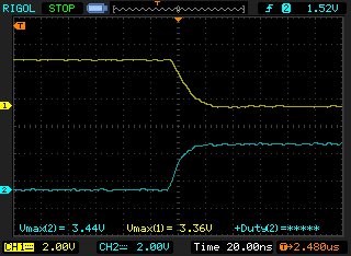

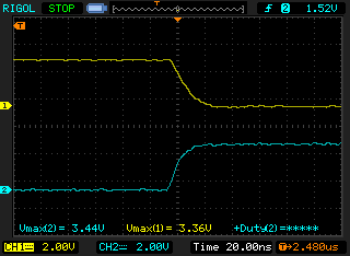

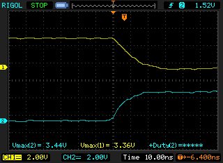

Dear champs,
I am asking this for our customer.

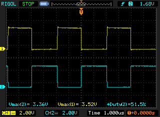

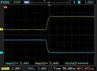

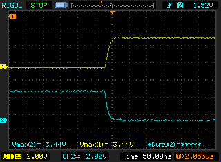

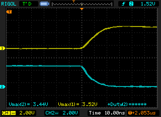

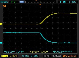

The user uses TI example "hrpwm_ex2_prdupdown_sfo_v8" with only modifying following line 286 and line 287 to set PWM1A and PWM1B in complementary.
On the oscilloscope snapshot below, the duty time of PWM 1A differs from the duty time of PWM 1B by about 17.6 ns. It appears the duty of yellow is larger than that of blue, which is not desired.
Questions:
1. In theory, the duty should be 50% in PWM1A and PWM1B. Why the difference time of PWM1A duty and PWM 1B duty is so large up to 10 to 20 ns, especially they are in HRPWM? The user desires the difference should be around 150 ps.
2. The user's goal is to have PWM 1A and 1B in complementary with 50% duty with fixed or changing periods. And the duty difference of PWM1A and PWM1B should be around 150 ps. What should the user do?

  • Wayne,
    I'd have to check something first, I have never seen CBU clearing the EPWM and CBD setting the EPWM in HRMODE. I'll get back to you.
    Nima

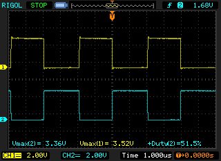

  • I am not able to see this on my setup. Here is the example code I wrote to check with this. The edges seem to line up perfectly.

    The results tested at many different duty cylces. This one is at 52.5%, all other were the same:
  • Dear Nima,
    We are still confused.
    Would you please make it clearer?
    1) The user cares about the "resolution of duty", not the alignment of rising edge and falling edge.

  • 1. Yes you will have 150ps resolution. The steps will be correct on both A and B channel. Try the code I sent you.
    51.5% sorry for the incorrect number.
    2. I will try that example and send you the results. I worked from the example I wrote to make sure no incorrect setting are there for the code I sent you.
  • Used the same code, changed the action qualifier as mentioned. Two lines only. everything works perfectly.
    Customer is incorrect. 150ps resolution with edges in the correct location with the settnig you requested.
  • Dear Nima,
    Per our offline discussion, the user should also control duty and update CMPAHR and CMPBHR along with updating TBPRDHR for keeping 50% duty in high resolution.
    (*ePWM[i]).CMPA.bit.CMPAHR = PeriodFine/2;
    (*ePWM[i]).CMPB.bit.CMPBHR = PeriodFine/2;
    I attached the code that has been verified.
    Thank you very much for you support.
    Wayne Huang
