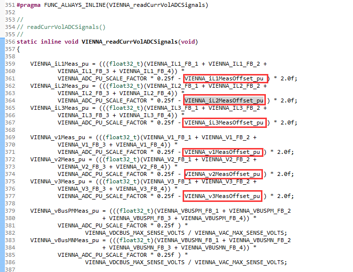

Through theoretical analysis and experimental verification, I found that  Vienna_ iL1MeasOffset_ Pu= 0.5, and obtained X through certain calculation, (I don't quite understand the calculation of the deviation)

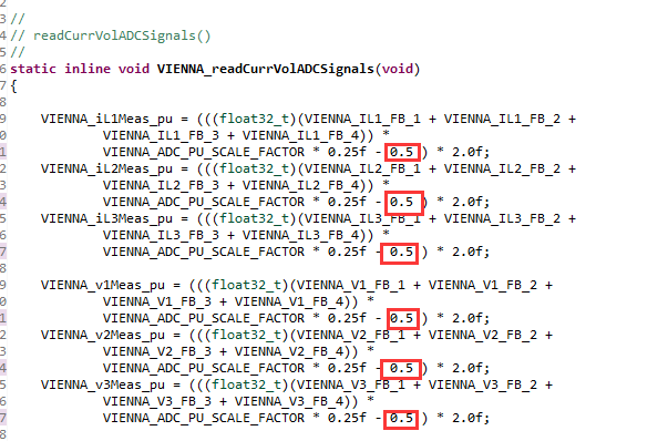

So I have a new idea, whether we can define  Vienna_ iL1MeasOffset_ Pu = 0.5 in the main function instead of calculating the deviation.
The details are as follows:
Change the VIENNA_iL1MeasOffset_pu in the red box to 0.5:
I don't know if this idea is right. Can you do an experiment to verify it?
