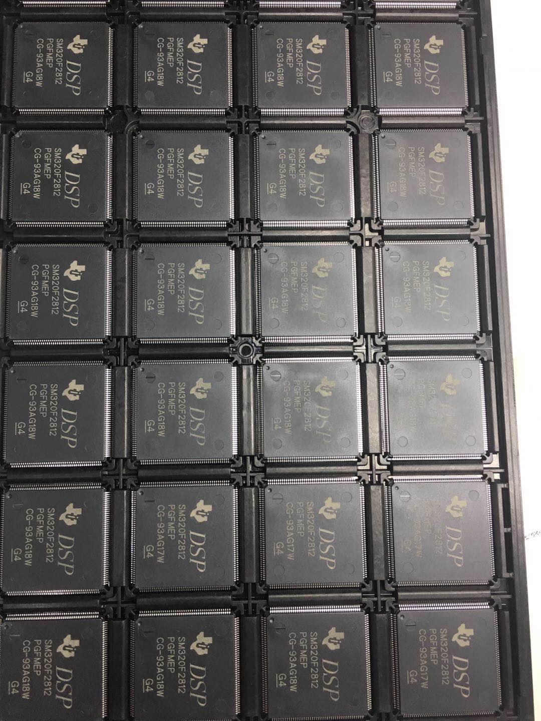

Hi TI expert,
What is the meaning of 93AG18W? What is the difference between 93AG18W and 93AG17W?
Hi TI expert,
It indicates the Year/month of manufacture. Please refer to page 2 of SPRZ193R for details.
Lot Trace Code
2-Digit Year/Month Code
Assembly Lot
Assembly Site Code
Wafer Fab Code (one or two characters) as applicable
Silicon Revision Code
