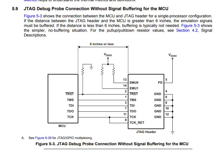

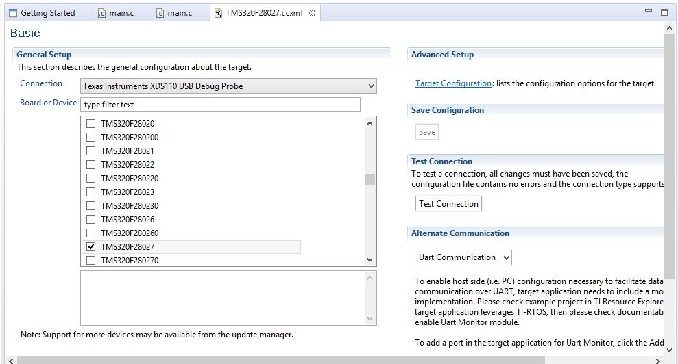

  I am debugging TMS320F28027 controller with XDS110 emulator. During flashing, I am getting the following error
C28xx: GEL Output:
Device Calibration not complete, check if device is unlocked and recalibrate.C28xx: Flash Programmer: Warning: The configured device (TMS320F28027), does not match the detected device (). Flash Programming operations could be affected. Please consider modifying your target configuration file.
C28xx: GEL Output:
Device Calibration not complete, check if device is unlocked and recalibrate.C28xx: Flash Programmer: Device is locked or not connected. Operation cancelled.
C28xx: File Loader: Memory write failed: Unknown error
C28xx: GEL: File: C:\Users\mohamedaslam.b\workspace_v9\gpio\Debug\gpio.out: Load failed.
Can anyone explain how to resolve this issue?
And I am mistakenly conneted the VDDIO pin to the ground through the capacitors during flashing? Is this reason for device lock?
