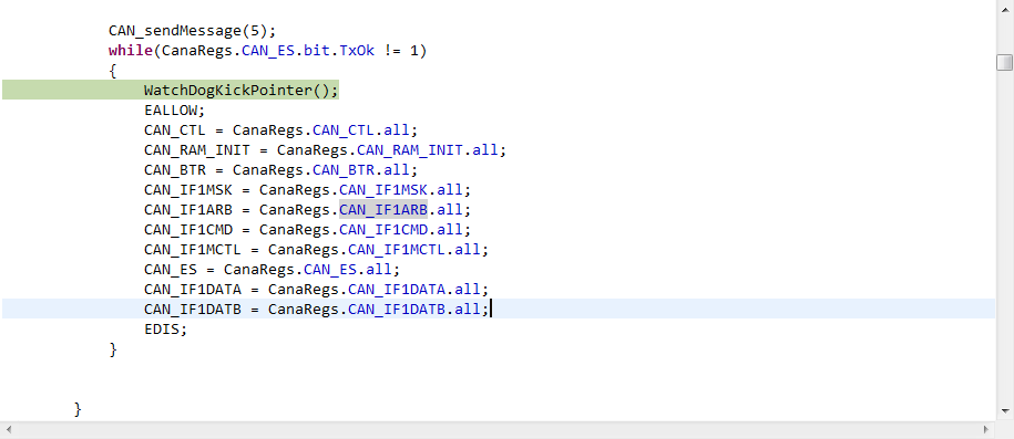

my customer debug the DCAN on F280049 with the help of SPRACE5.
In SPRACE5 page 4 with can_ex4_simple_transmit.c project they are expected to have waveform as shown in Figure3.
can_ex4_simple_transmit.c project is from:
C:\ti\c2000\C2000Ware_3_02_00_00\driverlib\f2837xs\examples\cpu1\can
They write their own code on F280049 code by imitating the example code and the file is attached, but they can only measure high on CANTx pin
Could you please help check where is wrong with the code? Thanks.

		while((CanaRegs.CAN_ES.all & 0x8000U) !=  0x8000U)
			WatchDogKickPointer();

             Debugging code is not something we can support on the forum. Please have customer run the example from SPRACE5 “as is” first. This would tell us if the H/W is good. Once this is confirmed, customer can start modifying the testcase. Did customer go through the debug tips I provided in SPRACE5?
  • Thanks.
    but the examples in SPRACE5 are all based on F2837X, we are modifying it to be used in F28004x.
    We are not able to use F2837x's example to tell if F28004x H/W is good.
    We checked that when our code runs to the while loop below, CAN_ES=0xE5, and after a while, CAN_ES becomes 0xE7.
    what may cause the issue?
  • Howard,
                  SPRACE5 has been written under Driverlib framework. You should be able to take the examples and run them seamlessly on other devices, provided you take care of the GPIO muxing. All this is clearly explained in SPRACE5. In any case, you should be able to run the examples in C:\ti\c2000\C2000Ware_3_03_00_00\driverlib\f28004x\examples\can. With the debug tips I have provided in SPRACE5, you should be able to find out the root cause easily.
    The error code you supplied indicate bus-off. What board are you running the code in?
    I also notice that the CAN module is being referred to as "eCAN". Note that on this device, we have the DCAN, which is not the same as eCAN found in older 28xx devices. This is unlikely to have any bearing on your code, but just wanted to make it clear that the two CAN modules are different and are not code-compatible.
