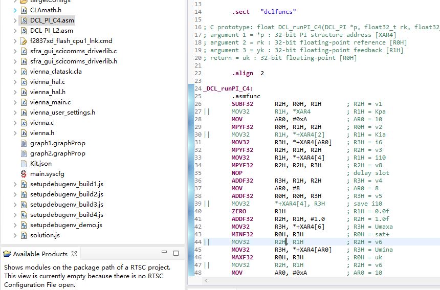

I was learning three-phase Vienna voltage outer loop, encountered a problem, as shown in the figure below:
I want to see "VIENNA_ GV_RUN" function,open it:
then,open "DCL_runPI_C4"
But I found that "DCL_runPI_C4" is an externally declared function
But I didn't find the specific function DCL_runPI_C4, was it DCL_PI_C4.asm?
