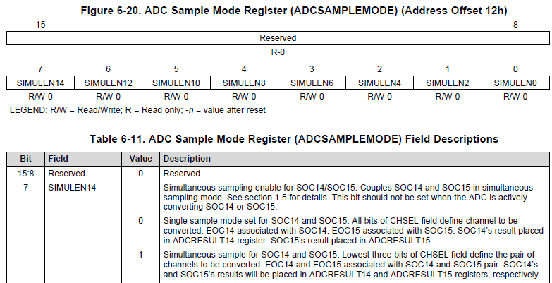

    You can find details about the ADC operation in the TRM.  The first piece of critical information is that the simultaneous sampling mode is configured through the ADCSAMPLEMODE register so you will need to use ADC_setSampleMode() where necessary.
    Another point is that the simultaneous samples will occupy sequential ADCRESULTn registers so you will not want to configure the SOCs that map to the paired result register:

    I modified the code now it works.
    Best regards
