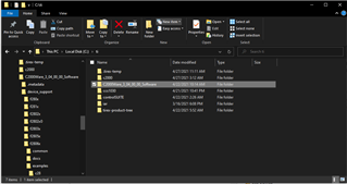

"Attached are the directory structure of the CCS installation and the help->about dialog box of CCS. These are the items I have installed; if not I'll gladly provide you with whatever you need.

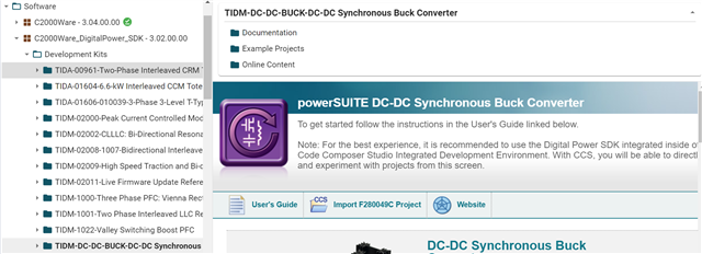

    Thanks for reaching out to the E2E forums.  I'm going to give some links to the cloud based implementations, but you can also find these in the PowerSUITE SDK which is a separate install vs C2000Ware.
    In order to import these examples you'll need to use the resource explorer inside of CCS View->Resource Explorer then navigate to the Software->Digital_Power_SDK->Development Kits->TIDM-DC-DC-BUCK-...(image below) or cloud resource explorer

    ""I have already done the things outlined outlined in your response.  I have attached a screen image of what the the referenced project looks like on my CCS screen.  As you can see, TIDM-DC-DC-BUCK-DC-DC->Example-Projects->F28004X exists but there is no similar example styled F28069M.  It may be that the one styled F28004X is a sort of generic project that can be used with the F28069M; I don't know.  The documentation describing using the F2004X does not mention the F28069M.  I don't think I know enough to be able to port the ...4x to the ...69M.""

    My apologies, I had seen the 28069 example in the install directory but I didn't notice that the resource explorer was only showing the F28004x implementation.
    I will follow up with the team on how to get this fixed.
    In the meantime, customer can download controlSUITE.  They will find the F28069 project in this path: C:\ti\controlSUITE\development_kits\BOOSTXL_BUCKCONV\v1_00_00_00\Buck_VMC_F28069M
