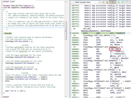

And finally I can not get InitFlash to execute correctly - loads to RAM but upon reaching statement to set first Wait State the instruction appears to want to take execution backwards 49 memory locations to make the wait state value assignment - only problem is that since we are now in RAM rather then FLAS where the InitFlash routine was program/loaded there is no statement there in RAM while there might have been such a statement in FLASH.
    On your InitFlash() issue, I don't think you have the function copied to RAM properly.  I can see in the screen shot you sent that the diassembly and op-codes are not correct.  For example, the first instruction in the C-source is EALLOW which is op-code 0x7622, but your diassembly window is showing an ADDL with opcode 0x07FA.  Also, notice it is showing multiplies (MPYB), bit test (TBIT), XOR, etc. for C-source code that is strict assignment.  Makes no sense.  I theorize that the RAM contents are garbage, and the function has not been copied correctly from flash.

  • Yes - on the FlashInit problem I found that I was giving the copying function the wrong addresses (changing from MemCopy to memcpy and did not complete teh argument shuffling that this requires.)

  • Factory team,
    I spent some time last week onsite with Greg to determine what was going on. Some changes were made relative to C++ instances and what we found was that if we programmed the Flash via CCS/JTAG and hit run the design would function properly. However, if you power down and disconnect the emulator the design does not operate correctly when powered back up (ie. in standalone mode). Output signals do not have the correct waveforms.
    What areas should be looked at that could explain the difference here?
    Tim
  • What do you mean by "Output signals do not have the correct waveforms" ?
    You can try checking what is in the GEL file used by CCS.  It is possible that the gel script is enabling something that the code itself is not, such as a peripheral clock.
  • Right.  A bit too generous a description.
    There were no waveforms, in fact.  Well, we saw what appears to have possibly been a GPIO pulled up then set to zero, rather than 10kHz bursts of 500kHz data across a SPI associated GPIO, or the 50kHz interrupt monitored on another GPIO.
    These signals are present when we appear to have been successful in using the JTAG emulator to boot to flash, which is followed by an ASM file copying flash to RAM, and then execution from RAM - all code and data executed from RAM after booting to flash.  Just no indication of execution when booting without the emulator (standalone - via power cycle).
    All TI examples that provide instructions for verifying that a standalone boot to flash will work are pretty much identical and have been followed with FAE on the premises.
    So if there is something else that must be verified while using the emulator then please provide an explicit description - the FAE is not on premises at present.
    Tim mentioned the GEL file and ran a test that was to have indicated such interference and the test results were negative.
    If there is nothing else that can be verified while using the emulator then some other means of diagnostics might be available.

  • A simple test would be to load a simple program to FLASH and verify that it runs.  This will confirm the board/device is properly booting from FLASH.
    You could also check the Xrsn pin to see if a reset is being issued.
    Another test would be to attempt to boot the device standalone.  Then connect the emulator through CCS.  You might be able to get an idea of where the PC is at by viewing the disassembly.  After you connect, you can also load SYMBOLS only for the program and see if you can determine where it is in the code.
  • Thanks Daniel.  Those are some of the kinds of things I was hoping I might be able to try: booting standalone and connecting on the fly
    How exactly should one expect a program, the emulator, and CCS to behave in such a situation ?  And what exactly are the actions you allude to me taking ? Can we assume that we start the program by booting standalone (via power cycle, no emulator physical connection) ?  And follow this simply by making the physical emulator connection ?  Then is a "connect" via CCS necessary (which menu, selection, etc ?  What should be in place in the way of a target icon/selection on a pull down menu that I might need to configure/select ?  The program is running at the time of "connect", however "connect" is achieved ... so how do I inspect instructions (source, or assembly) or the program counter while the program is executing ?  Loading symbols only after connection when booting to flash using the emulator is something I have accomplished under the instruction material available in various Boot to Flash" TI documents; it's normally followed by a Reset, and stepping through the program to c-int00.  I have accomplished all of this when booting using the emulator - and these steps are supposed to confirm that the program is ready to be booted to flash stand-alone, but that's not totally true is it ?  Can those steps be varied (using the emulator) to determine better what's happening to prevent execution when not using the emulator ?
  • What kind of board are you running?  If you are controller a power stage with C2000, be aware that the device will be halted when you connect with the emulator through CCS.  This can cause PWM and GPIO signals to get stuck in their current state.  From what I read though, it seems you are using C2000 for communications mainly so you should be safe.
    When I say "connect" I mean physically connecting the emulator to the JTAG pins and then connecting to the device itself using CCS debug.
    One way to do this in CCS is to-
    First view your list of target configurations (View-> Target Configurations).
    Then right-click on the configuration you are using and choose "Launch Selected Configuration" which will launch the CCS Debug mode.
    Once the Debug mode is loaded, you will see the C28x core listed in the "Debug" window below the target configuration you launched.
    You can then connect to the C200 device (Run-> Connect Target) and try to determine where the code is halted at.
    If you load the program symbols, it will let you see the actual line of code it is at, instead of just the disassembly information.
    Do not perform a Reset after conenctiong since that would reset the device and cause you to lose any information available to determine if the device is running the code and perhaps getting stuck somewhere.
  • Beautiful, Daniel.  I think I should be able to work with this until I hit another wall or find my solution.  Is there any willingness on your end to take a small code dump and help with the additional expertise you have ?
