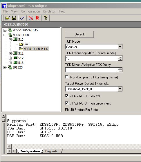

  • Friedrich,
    It occurs to me that XDS510LC uses a 13 MHz default JTAG clock, whereas XDS100 uses 1 MHz (I think).  Something like that.  Point is, if XDS100 is working but XDS510LC is not, and the problem is because of some board issue on your board, try slowing down the clock on the XDS510LC.  I think you can do this using the SdConfigEx utility.  You should have gotten an icon for this when you installed CCS.  If not, try here: C:\TI\ccsv5\ccs_base\emulation\specdig\sdconfigex\SdConfigEx.exe.
    When you run SdConfigEx, I think XDS510LC is covered under XDS510USB emulator at address 0x510.  Change the 'TCK Frequency' to say 1 MHz, and try it.  Frankly, I've never had much luck doing this, and I'm not positive on whether XDS510LC is covered under XDS510USB.  You'd have to check with Spectrum Digital to be sure.  Regardless, you can easily try it and see if it helps.
    David

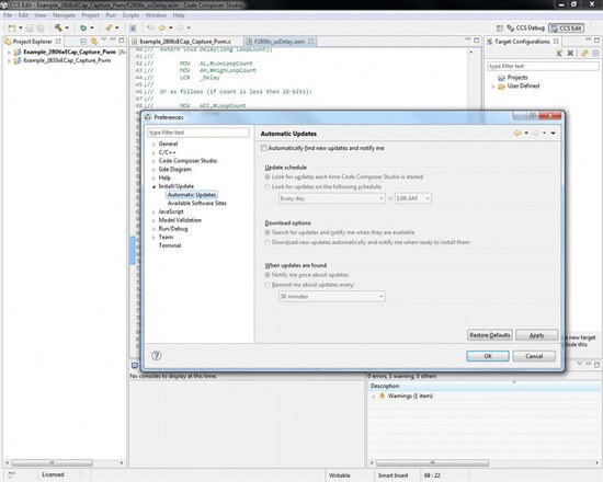

  • Friedrich,
    In CCS5.x, you should be able to go to:
    Windows->Preferences...
    Install/Update->Automatic Update
    and then uncheck the "Automatically find new updates and notify me" checkbox
    Please let us know if this fixes the issue.
