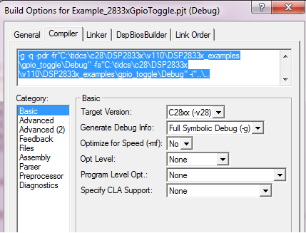

  • Most likely you are missing the -v28 (or --silicon_version=28) command-line option.

  • Check your build properties and make sure you are selecting 28x option.
    Manoj

  • Did you make sure to check whether your build options looks like the one below?
  • Please refer the example projects provided on the control suite (or) web. You seem to have include header files in Source files which is wrong.
    -Manoj
  • Yes.... I confirmed this aspect. But still there is a problem.

       library search path under project->build options, linker tab,
       library search path (-i).
