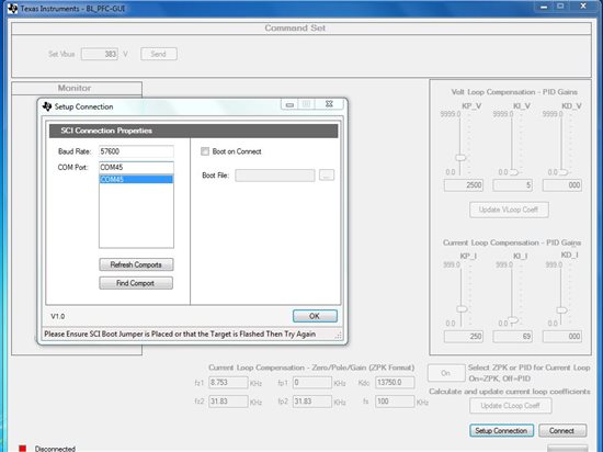

Hello everyone,
We have a BLPFC kit in our lab. We have installed CCS and controlSuite. Now the GUI for this BLPFC kit is available from controlSuite.
But we are not able to connect.
Can anyone help in this matter..?
  • Hi Vikas,
    So you're using COM port for communication? (USB to Serial converter or Inbuilt CPU one)
    Gautam
  • Hi Gautam,
    Yes I am using COM port.
    In the GUI "Setup Connection" it finds the com port, but when I click "Connect" button it gives some error "Access to Port xx is not available".
    In my case COM port no. is 45 and I have checked that this port is available.
    Any help would be great.
    Vikas

  • Hi Vikas!
    Did you try to apply “Find Comport” tool of BLPFC-GUI?
    Igor
  • When I use the GUI for BLPFC kit,it is not able to connect with the board.
    In the GUI "Setup Connection" it finds the com port, but when I click "Connect" button it gives some error "please load a valid .a00 file".
    Can you give me a hand?
    On the GUI "Setup Connection" it finds the com port, but when I click "Connect" button it gives me "Could not connect:please check connection"
    And I have another question that if AC source supply to the BLPFC EVM is necessary before using the GUI.exe.

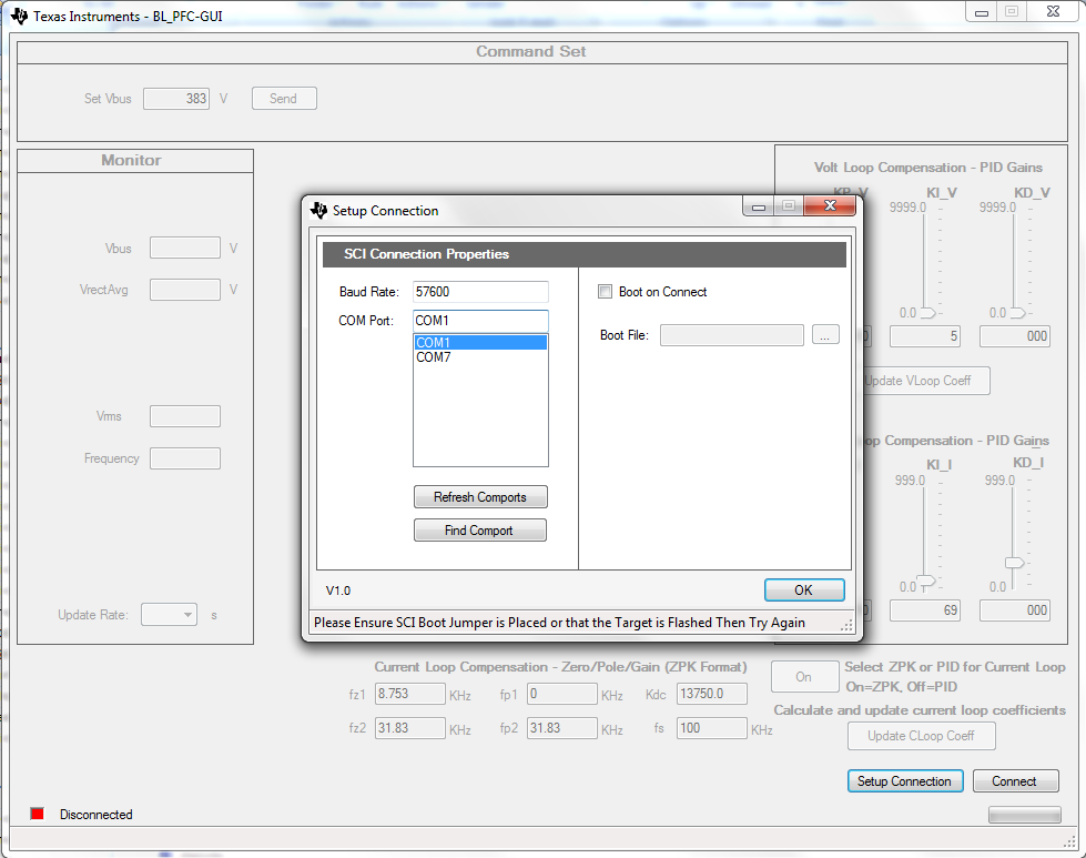

  • Hello, not sure this has been resolved, but I am also having issues connecting the GUI up to the board.
    On the board I have the following jumper settings.
    Jumper/Switch No.
    Jumper/Switch Connection
    Comments
    J3, J4, J5 & J8
    Pin 1-2
    J7
    Pin 2-3
    SW1
    Switch position away from the side labeled Ext.
    I apply ONLY the 12 VDC supply (I just want to see if I can connect the GUI up).
    I change the SW1 position to point towards the EXT.  At this point I get a solid GREEN LED on the piccolo board and a blinking RED LED.
    I launch the GUI and setup.  It finds my USB com port.  I hit continue and it states - "Please Turn EVM Board Off then Press "Continue"".
    I turn the SW1 away from EXT (no GREEN or RED LED) and hit continue in the GUI.  It tries to communicate and then says "Please Turn EVM Board On then Press "Continue"".
    I turn the SW1 towards EXT (see solid GREEN LED and blinking RED LED).  I hit continue in the GUI.
    It tries to communicate then says "Please Ensure SCI Boot Jumper is Placed or that the Target is Flashed Then Try Again".
    Which jumper is associated with the SCI Boot?
    Not sure what the blinking RED LED is indicating?
    I am trying this right out of the box (i.e. I have not over written the default application in the FLASH).
    Any help would be greatly appreciated.
    Brent

  • Brent,
    I don't mean to second-guess, but can you double-check the "Boot on Connect" setting for me?  If that setting is unchecked, it shouldn't ask you to turn the board off, turn it back on, and the error message shouldn't suggest anything about SCI boot jumpers.
    Long ago we chose to have the power LED be green and the IO controlled LEDs (LD2 and LD3) be red on our controlCARDs.  Often we toggle one of our LEDs to show that the MCU is actively running code and for this kit we toggle GPIO34 (which ties to LD3). The fact that it is blinking is actually a good sign in this case.
    Thank you,
    Brett
  • Trust me, no problem second guessing. :)   I captured a screen shot.  Notice it mentions the SCI boot jumpers.
  • Brent,
    Alright, I think I get what's going on now.  I assume you're clicking the Find Comport button to try to choose the right comport.
    If so, don't.  Click on the comport you know it to be (use the 'manually find the comport' option).  Once you've chosen the right comport click 'OK'.  Then in the main GUI window click 'Connect' and all should work.  (if it doesn't, it will at least throw a new error now :) )
    Thank you,
    Brett
  • That is good information Brett.  Unfortunately I get a "Could not connect:  Please check your connections"
    I have tried this on two computers (both running CC4).  When I first plugged in the USB cable it is able to install a driver and I do see the com port in my Device Manager.
    If you think of anything else to try, let me know.
    Brent
  • Brent,
    Getting closer then...
    Is [M5]-J4 populated?  (the jumper labelled J4 within the M5 hardware macro section)
    Is the controlCARD's SW1 switched toward 'OFF' (down)?
    Let me know how the above goes.
    Thank you,
    Brett
  • Hi Brett,
    Found out the issue.  My bad.  When I launched the GUI, it shows a baud rate of 57600.  I was assuming it was configuring the com port for this baud rate.  In Device Manager when I looked at the properties for it, it still showed 9600.  When I switched this to 57600 in Device Manager, it works.
    Thanks for all of your help, I appreciate it.
    Brent
  • Brent,
    That's great.  I'm glad that were about to find the issue and get things working,
    Happy experimenting!
    Thank you,
    Brett
