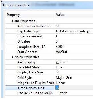

  • In orden to show all the grafics i have to go to "tools==> Graph ==> single time"  and set the Graph properties in real time simualtion, to show for example "AdcBuf"
    I haven't an oscilloscope in my home, is important to know so that i can show all my signals like PWMs signals..
  • Yes, you can make use of the graph tool available in the CCS.
    Gautam
  • The graph tool can plot data from memory. It cannot plot signal generated by PWM peripheral.
    Maciej

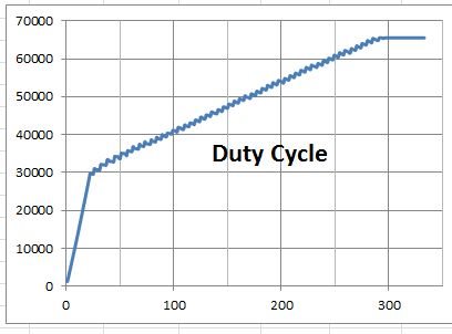

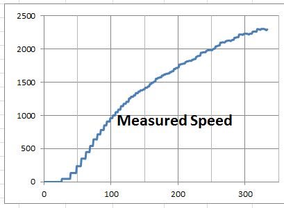

    Here's "proof" - Tjarco's idea - harvested via transfer - ARM's SRAM to Excel: (BLDC motor - 2300RPM Target - under load)
    Scale: Hor mS, Vert. RPM (top), PWM variable (bottom)  Data (2 of 12 different - 32 bit values) captured @ 1mS intervals

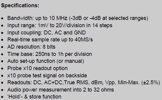

  • Hi Guys, an electronic shop near my house is selling the follow oscilloscope HPS140i with the following characteristics :
    Here you are the link: http://www.hps140.com/
    The question is:
    My exercises consist of generating signals PWMs of 10KZ, 50KHz and a signal PWM with period of 500 miliseconds.
    ¿Can I show the PWMs signals of the PICCOLO with the Oscilloscope HPS140i, if it working at 10MHz?,  taking into account the piccolo works up 60 MHz, but i think the PWMs signals of the PICCOLO are signal bellow 10MHz. ¿am i right?..
    For example show  the waveforms of ePWM1 and ePWM2 signals will be imposible to show with hps140i oscilloscope. ¿am i right?
  • Hi Mileva!
    1 Objectively. This is a acceptable option for your current task.
    2 Subjectively. AD resolution 8 bit is not enough (better 12).
    3 Rerspectively. 10 MHz is not enough (better 50-100). But now it is difficult to determine your future needs.
    You need to decide himself. Based on your financial possibilities.
    Good luck,
    Igor
